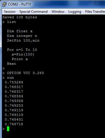

  Quote  There is a bug in analogue input
This appears to be 100-pin specific - more testing needed but analogue on the 144 works fine.
If anyone has a 100-pin EFG please could they test analogue input
Current status is that it works fine on EFM but fails on EFH
Minor tweak for 64-pin which definitely works for analogue.
2017-07-28_160230_mmx645.4.05.zip
Remember on the MMX you can set the analogue reference voltage which is used to calculate the analogue levels
OPTION VCC N.NNNN
This option is not stored and defaults to 3.3 everytime the MMX is powered upEdited by matherp 2017-07-29

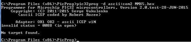

never used pic32prog and my mmx100 has a hard soldered 1454
I installed it and found the port but no matter what baud rate I set it to it always says "FAIL" (yes i am pressing the mode button and getting a red LED)
I would happily test but I am a bit stuck with only 2 mins of playing in between work.

Posts: 2991
Posted: 06:44am 28 Jul 2017
Try following from a command prompt (assuming you running Windoze?):
pic32prog -d ascii:comx filename.hex
Substitute Port number (x) and exact filename. Make sure .hex file in same folder as pic32prog.exe
This is how I installed your MMX firmware into the 100pinner (not forgetting the Mode button press to turn on the red LED )
Edited by WhiteWizzard 2017-07-29

  WhiteWizzard said   Try following from a command prompt (assuming you running Windoze?):
still no joy. Complains it can't configure the port even when i force the baud rate on the port

Posts: 2991
Posted: 09:11am 28 Jul 2017
Andrew,
Which driver did you install? Have you got the MicroChip driver?
Worth uninstalling and re-installing (link on Geoff's site - scroll to bottom of page)

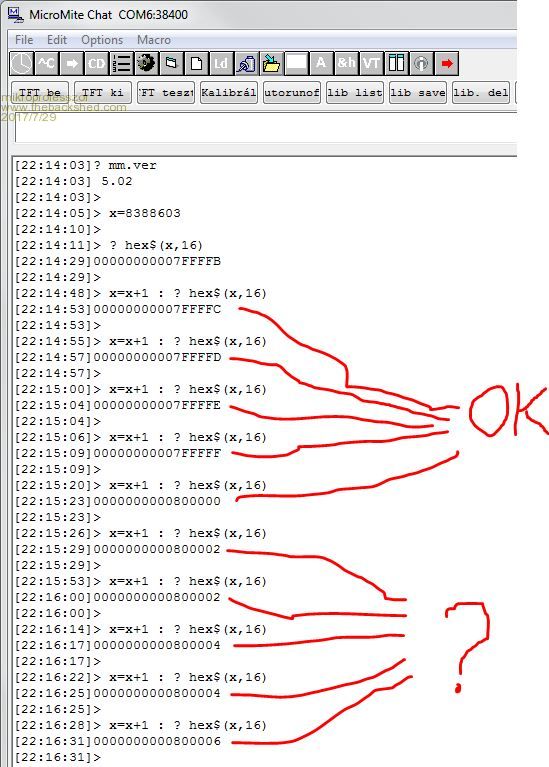

Hi everybody,
I'm a newby in the using of this forum.
Would anybody reply for my problem?
I use the Micromite 5.2 system for a simple program and I gave up to figure what I do in a bad way?
May be I caught an arithmetic bug in Micromite?
I should like use the 64 bit integer to store coded informations but the program code running unexpected way.
Larger numbers than 8,388,608 (hex80 00 00) the LSB bit of the result of neither arithmetic or logic operation vill be wrong.
See the picture of consol's history below:
Posts: 6607
Posted: 02:40pm 29 Jul 2017
Hi and welcome to the shed.
You need to specify Integers. By default, MMBasic uses floating point numbers and as you have seen, they are not exact.
Either set the default to integers or use the % suffix for integers
> x% = 8388603
> print hex$(x%,16)
00000000007FFFFB
> x% = x% + 1 :print hex$(x%,16)
00000000007FFFFC
00000000007FFFFD
00000000007FFFFE
00000000007FFFFF
0000000000800000
0000000000800001
0000000000800002
0000000000800003
0000000000800004
0000000000800005
0000000000800006
0000000000800007
read "MMBasic Characteristics" in the micromite manual for more details.

Posted: 09:51pm 29 Jul 2017
Jim: Many thanks you for enlightening me!
(I note only in brackets: I used to write "Option default integer" in the very first line, except in this program)
Conclusion and recommendation: the electronic machine is always right!

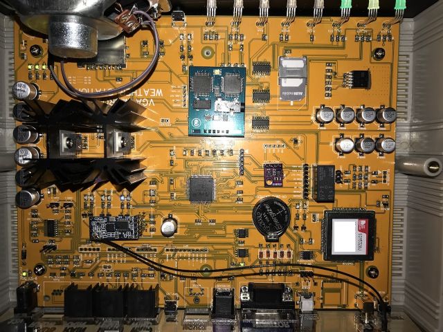

I dont have enough knowledge to provide any useful input into the problem with AIN, but can report that I have 2 boards of my own design currently with PIC32MZ2048EFH100 installed running the latest firmware and using analogue inputs. I have had no issues with this or earlier firmware using analogue inputs if this helps.
This is the board for interest - Its a weather station with 3G chipset to provide voice weather report and the display is repeated wirelessly to an additional MMX as a remote display
Works well, but I'm sure there are mistakes
