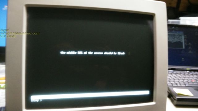

does anyone out there have a real VT100 terminal hooked up to a micromite? i'm getting down to the finer details of implementing VT emulation, and am finding a fair bit of uncertainty in the existing sources of information. one big question regards the 'scrolling region'; when a region is set up what commands respect it, and what ones ignore it?
the below bit of mmbasic code checks to see if erase commands overflow the scrolling region or not (teraterm does overflow the region).

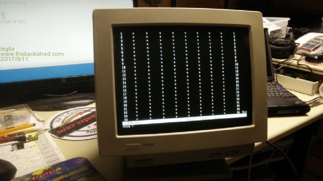

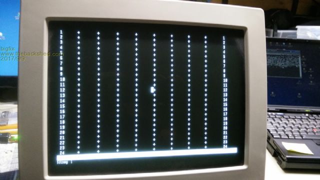

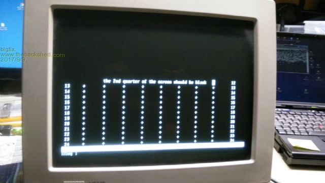

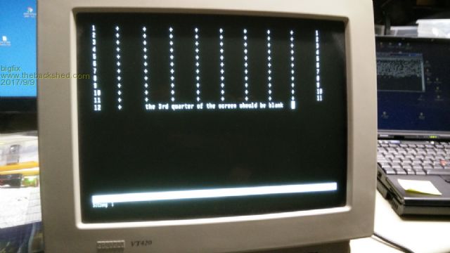

Rob,
my "real" VT100 are deep buried in storage - would take hours to get them
I grabbed a VT420
Surprise - powered up after being 20 Years on shelf...
Put it into VT100 Mode in setup, even VT100 ID
Next challenge was to get a 3V TTL to V24 25 Pin Female converter done
After some hickups with undocumented chinese modules it finally worked
Even when I turned off smooth scroll the VT420 still showed some buffer overrun garbage with your program
DEC Terminals really depended on Xon/Xoff - which we do not have at MMites...
- had to set it to 9600 Baud - finally worked
MMite is a LCD Backpack, original Version, MMBasic 5.2
Some screens look different to the comments
I did not analyse the CSI sequences yet - just runned the program
I only post the first & the "failing" screens
cheers
Guenter

  bigfix said  Some screens look different to the comments
cheers
Guenter
excellent, that shows that i don't need to modify the erase functions to respect the scroll region, though i am a little surprised at this behaviour. none of the online material i looked at made it clear about what the expected behaviour was.

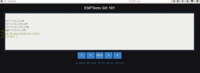

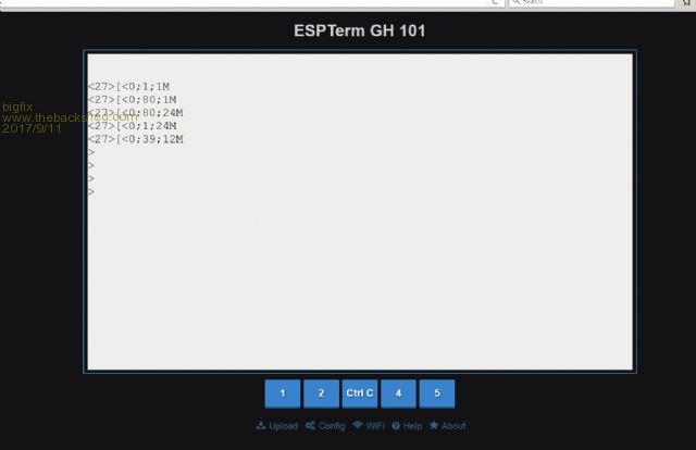

Posts: 2552
Posted: 02:54am 11 Sep 2017
excellent, that has enabled me to now finalize how i handle cursor movement commands.
btw, how well does the following work with ESPTerm?
Const ESC=Chr$(27)
Print ESC "[?9h"; ' enable mouse reporting
Print ESC "[?1015h"; ' select URXVT encoding (if available)
Print ESC "[?1006h"; ' select SGR encoding (if available)
Do: A$=Inkey$: Loop Until A$<>""
If A$=Chr$(27) Then Print
If Asc(A$)<32 Then Print "<" Str$(Asc(A$)) ">"; Else Print A$;
Loop Until A$=Chr$(26)
Print ESC "[?1006l"; ' disable SGR encoding
Print ESC "[?1015l"; ' disable URXVT encoding
Print ESC "[?9l"; ' disable mouse reporting
it makes use of alternative encoding for the mouse location reporting - SGR (1006) is the preferred reporting method, URXVT (1015) is ok but not great, while the default encoding can not encode beyond column 95 if using 7-bit characters.

Posted: 11:11am 11 Sep 2017
Tested it on 1.01 ESPTerm
One issue I found - Mouse stays enabled ??
Need to investigate
Anyhow, this is the output clicking on the 4 Corners & Center
When I use the right mousebutton then first number changes from 0 to 2
It also works excellent on an Android tablet with touch
Wide Terminal with 120 Characters:
