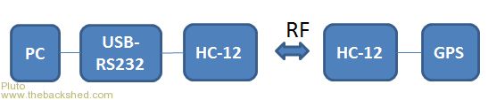

I made this test a couple of months ago:
GPS and the right-side HC-12 were powered by 3.3V, while the left side HC12 got power (5V) from the USB-RS232 (CP2102). Walked around the block with the GPS&HC-12 unit, which transmitted the GPS messages to the PC.
The GPS data received were then plotted on the map by the software found at http://www.hamstermap.com/quickmap.php
In this way I could easily see how far the HC-12 communication worked. (A few hundred meters when not too many houses between TX and RX. Only small spring antennas on the HC-12 units.)
Found out later that it would have been even easier with Ublox u-center software, which plots GPS data directly on Google Map.
The original reason for making the setup with HC-12 was that the logic signals directly from the GPS-unit were not recognized by any terminal programs in my PC. Picoscope did however recognize and decode the GPS messages correctly. The trick with two HC-12 worked well.
In fact it was a "wireless level translator" for 3.3V TTL to 5V TTL.
I did not see any issues by operating at 3.3V. The HC-12 on-board processor is specified down to 2.95V and the RF-chip Si4463 down to 1.8V.
TX power will however be reduced if the voltage decreases. The difference between 3.3V (+20dBm) and 3.0V (+19dBm) is about 1dBm.
