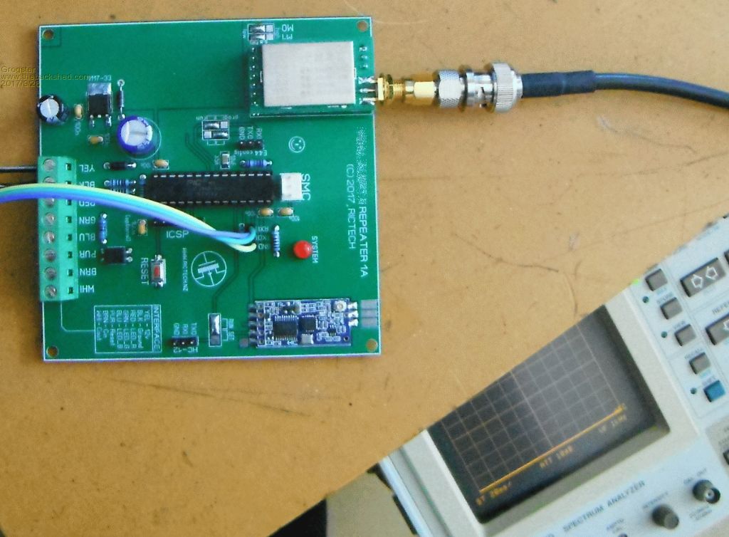

I had a spare microsecond today, so tested the E44 module on the analyser.

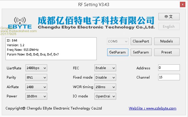

Module settings:
Module setup for testing:
Direct connection to spectrum analyser, 10mW output power.

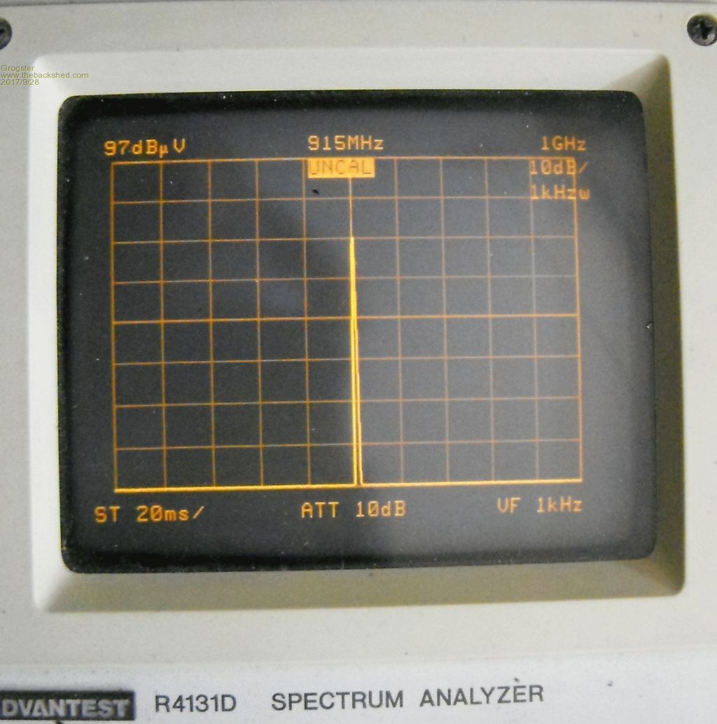

Spectrum @ 1GHz bandwidth:(500MHz either side of 915MHz center-frequency)

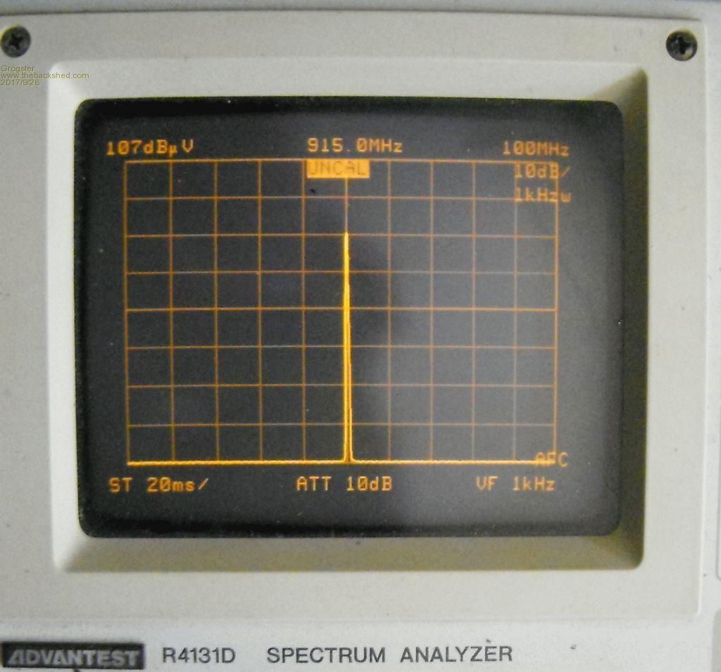

Spectrum @ 100MHz bandwidth:(50MHz either side of 915MHz center-frequency)

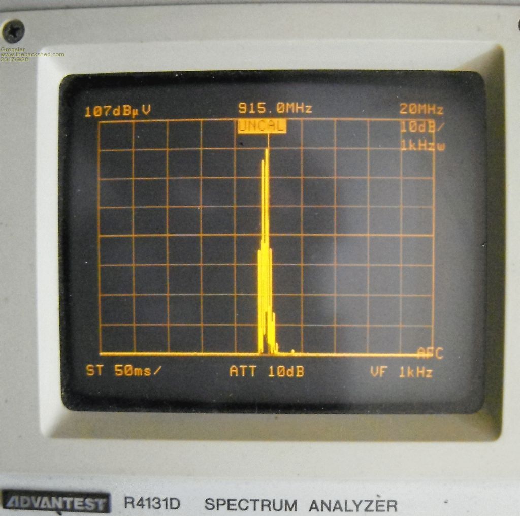

Spectrum @ 20MHz bandwidth:(10MHz either side of 915MHz center-frequency)

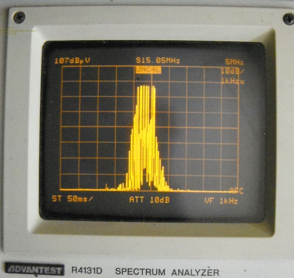

Spectrum @ 5Mhz bandwidth:(2.5MHz either side of 915MHz center-frequency)
I have to say that I am rather pleased with the results of this test, and they don't appear to be radiating any kind of harmonics or spurious signals onto the spectrum outside of where they are supposed to be sitting.
I would happily recommend these modules to a friend.
These analyser shots are only relevant for the E44 module @ 915MHz.
Other modules - even from the same series(such as the 433MHz ones) would need separate testing to confirm what they are doing, but I expect they are also as clean as the 915MHz ones. This would need testing to prove it one way or the other though.
Based on these tests, I am happy to put them on-air. If you are a New Zealand member reading this, RSM allow up to 1000mW on this band, so you can run these at the full 100mW output power if you like - that should allow them to go a fair distance!
