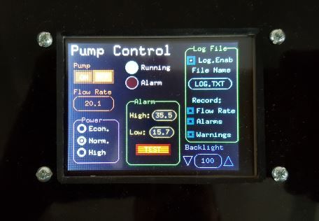

While testing all GUI commends on the MM Plus, I have found very useful the possibility to modify Geoff's program 'Pump Control" to fit into the ILI9341 smaller 320x240 LCD. (Thanks Geoff )
I hope it can assist many others. ..:

Option Explicit
Dim ledsY
Colour RGB(white), RGB(black)
pwm 2, 1000, 50
' reference numbers for the controls are defined as constants
Const c_head = 1, c_pmp = 2, sw_pmp = 3, c_flow = 4, tb_flow = 5
Const led_run = 6, led_alarm = 7
Const frm_alarm = 20, nbr_hi = 21, nbr_lo = 22, pb_test =23
Const c_hi = 24, c_lo = 25
Const frm_pump = 30, r_econ = 31, r_norm = 32, r_hi = 33
Const frm_log = 40, cb_enabled = 41, c_fname = 42, tb_fname = 43
Const c_log = 44, cb_flow = 45, cb_pwr = 46, cb_warn = 47
Const cb_alarm = 48, c_bright = 49, sb_bright = 50
' now draw the "Pump Control" display
CLS
GUI Interrupt TouchDown, TouchUp
' display the heading
Font 1,2 : GUI Caption c_head, "Pump Control", 5, 0
Font 1 : GUI Caption c_pmp, "Pump", 10, 35, , RGB(brown)
' now, define and display the controls, first display the switch
Font 1
GUI Switch sw_pmp, "ON|OFF", 10, 50, 75, 25, RGB(white),RGB(brown)
CtrlVal(sw_pmp) = 1
' the flow rate display box
Font 1 : GUI Caption c_flow, "Flow Rate", 10, 85,, RGB(brown),0
Font 1 : GUI Displaybox tb_flow, 10, 100, 75, 27
CtrlVal(tb_flow) = "20.1"
' the radio buttons and their frame
Font 1 : GUI Frame frm_pump, "Power", 10, 145, 85, 81,RGB(200,20,255)
GUI Radio r_econ, "Econ.", 25, 161, 8, RGB(230, 230, 255)
GUI Radio r_norm, "Norm.", 25, 184
GUI Radio r_hi, "High", 25, 206
CtrlVal(r_norm) = 1 ' start with the "normal" button selected
' the alarm frame with two number boxes and a push button switch
Font 1 : GUI Frame frm_alarm, "Alarm", 110, 110, 100, 120,RGB(green)
GUI Caption c_hi, "High:", 116, 130, LT, RGB(yellow)
GUI Numberbox nbr_hi, 159,MM.VPos-3,45,MM.FontHeight+6,RGB(yellow),RGB(64,64,64)
GUI Caption c_lo, "Low:", 116, 162, LT, RGB(yellow),0
GUI Numberbox nbr_lo, 154,MM.VPos-3,45,MM.FontHeight+6,RGB(yellow),RGB(64,64,64)
GUI Button pb_test, "TEST", 128, 191, 65, 20,RGB(yellow), RGB(red)
CtrlVal(nbr_lo) = 15.7 : CtrlVal(nbr_hi) = 35.5
' draw the two LEDs
Const ledsX = 120, coff = 25 ' define their position
ledsY = 45 : GUI LED led_run, "Running", ledsX, ledsY, 12, RGB(green)
ledsY = ledsY+29 : GUI LED led_alarm, "Alarm", ledsX, ledsY, 12, RGB(red)
CtrlVal(led_run) = 1 ' the switch defaults to on so set the LED on
' the logging frame with check boxes and a text box
Colour RGB(cyan), 0
GUI Frame frm_log, "Log File", 222, 10, 100, 177, RGB(green),0
GUI Checkbox cb_enabled, "Log.Enab", 225, 25, 15, RGB(cyan)
GUI Caption c_fname, "File Name", 235, 45
GUI Textbox tb_fname, 228 ,67, 80, 20, RGB(cyan), RGB(64,64,64)
GUI Caption c_log, "Record:", 235, 102, , RGB(cyan), 0
GUI Checkbox cb_flow, "Flow Rate", 225, 122, 12
GUI Checkbox cb_alarm, "Alarms", 225, 142, 12
GUI Checkbox cb_warn, "Warnings", 225, 167, 12
CtrlVal(cb_enabled) = 1
CtrlVal(tb_fname) = "LOG.TXT"
' define and display the spinbox for controlling the backlight
GUI Caption c_bright, "Backlight", 221, 191,,RGB(200,200,255),0
GUI Spinbox sb_bright, MM.HPos -80, 210, 100, 25,,,10, 10, 100
CtrlVal(sb_bright) = 100
