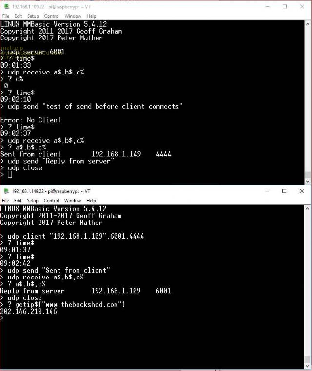

Please find attached version 5.4.12. This now includes full support for UDP messaging and conversion of internet addresses:
2017-10-17_080857_mmbasic-stretch.zip
2017-10-17_080909_mmbasic-jessie.zip
The picture shows an interaction between a Pi Zero W, running Jessie (top) and, on the bottom, a Pi 3 running stretch
The Pi zero is configured as a UDP server listening on port 6001. It tries to receive a message but there is nothing there (the port number of the client is set to zero and the message itself and the client address are blank strings). The RECEIVE command is non-blocking and always returns immediately.
It tries to send a message but can't because there is no client
The client then sends a message and the server repeats the read command. In this case the message is received and the server reports the message and who sent it. At this point the server knows the address and receive port for the client and can now send a message.
The server sends the message and the client successfully receives it.
Note on the client screen the use of the function GETIP$() to return the IP address for www.thebackshed.com

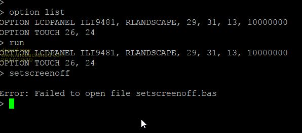

Hi Peter,
I am not sure how hard it is, but would it be possible to call SUBs and Functions from the command line once a program is loaded. It currently thinks all not valid commands are an attempt to load a file. This helps when debugging etc.
Also another small one. The SYSTEM command returns the last line of the output twice from what I am seeing.e.g
SYSTEM "ls -al"
shows the last file twice.
Gerry

Posts: 11954
Posted: 12:14am 19 Oct 2017
  Quote  I am not sure how hard it is, but would it be possible to call SUBs and Functions from the command line once a program is loaded.
This appears to be an either/or
We can either be able to execute programs as a single command or execute internal subroutines/functions.
My instinct is to make the change to run internal functions. You can always execute a program from disk with "RUN filename"
Views?
  Quote  The SYSTEM command returns the last line of the output twice from what I am seeing.e.g
SYSTEM "ls -al"
Fixed, will post update once decision on above is confirmed
disco4now
Joined: 18/12/2014
Posts: 1157
Posted: 12:25am 19 Oct 2017
I like the 'RUN filename' option and the ability to call SUBs and Functions from the command line as part of testing/debugging.
Gerry

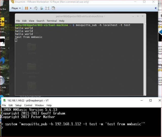

Posts: 11954
Posted: 03:39am 23 Oct 2017
  Quote  I also think MQTT is one missing piece in the MicroMite Universe
This shows the Pi-cromite publishing to a MQTT broker (server) running on a linuxmint virtual machine running under VMware on my PC. The subscribing client is also running on the linuxmint VM
No need for any changes to the Pi-cromite code. Note the use of single quotes for the message
Just install the mosquitto client on the raspberry pi running mmbasic
sudo apt-get install mosquitto-clients
Edited by matherp 2017-10-24
bigfix
Joined: 20/02/2014
Location: Austria
Posts: 132
Posted: 04:25am 23 Oct 2017
My most optimistic guess was that you solve this in less than a week
But I forgot about the power of a real OS & MMbasic hybrid, you created here !
So all the lowlevel stuff like keepalive is handled in the Mosquitto client outside MMbasic - right ?
To get a realtime state of the subscribed topic into MMbasic I need to issue the relevant system commands in regular intervals - basically polling the Mosquitto client ?

Posts: 11954
Posted: 04:51am 23 Oct 2017
  Quote  To get a realtime state of the subscribed topic into MMbasic I need to issue the relevant system commands in regular intervals - basically polling them ?
Yes, but I haven't found how to do a non-blocking poll with mosquitto_sub. You can set the count of messages "-C 1" so that it terminates after it sees the first message but there doesn't appear to be a timeout. I assume this is just a limitation of the mosquitto client. Using mmbasic to publish though is trivial as per the example.
