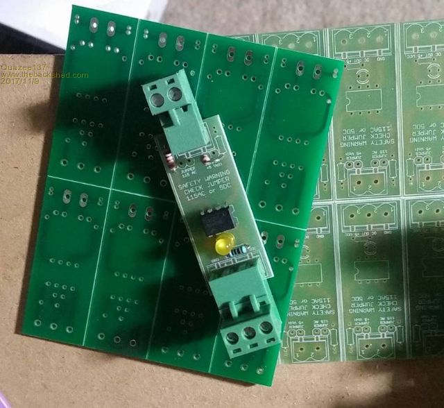

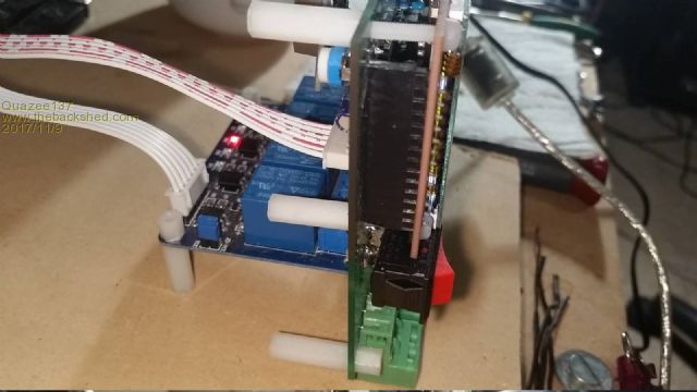

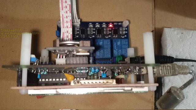

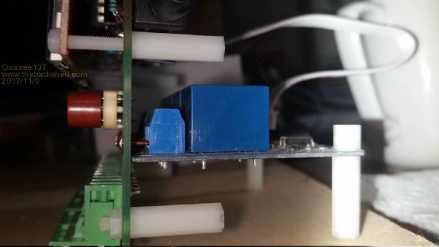

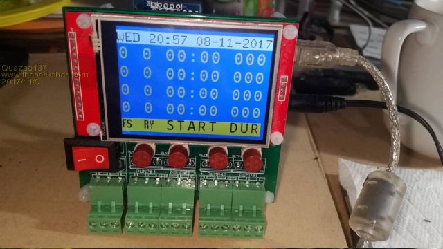

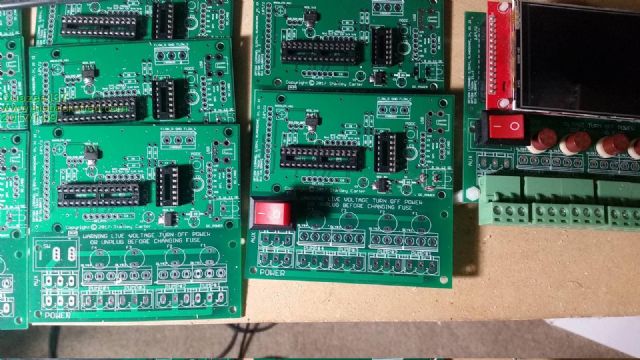

Quazee137
Joined: 07/08/2016
Posts: 603
Posted: 08:40pm 08 Nov 2017
I use eagle 7.2 not going to 8 now that autocad wants a $$$$$ for a seat.
I have been getting my boards from pcbgogo.com
boards have been great.
I cant seem to get my pictures to post? (it does not like a # in the image name)
The cheap quad relay boards was a pain to wire up so
this started out as only a relay aide but was then asked
why now put the controller on the top half and here it is.
These are a mains detector so a PLC knows what pumps/valves are powered.
Edited by Quazee137 2017-11-10
