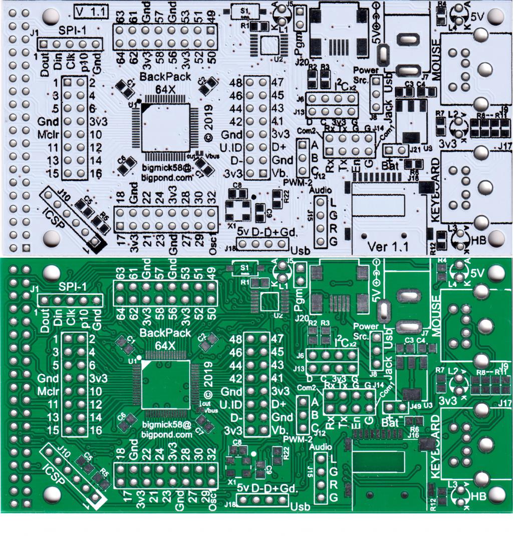

Anyway their quality is great although I got some WHITE Pcbs with Black text and they had some blurring issues but their white on Green is as good as i have ever seen.
Here is a scan of two boards (Green is BackPac-64X version 1.0, white is 1.1 and I have 1.2 in being produced now) note that the white on green is very clear in comparison to the black on white, I suspect this is due to the fact the white soldermask is very thick and glossy so the black ink tends to not adhere as well as the thinner more matte green.
