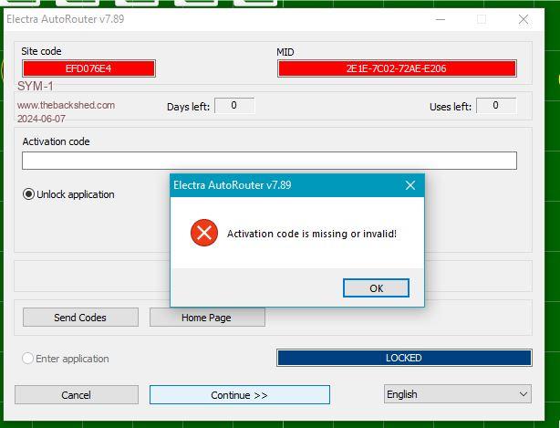

I have just created a PCB using dex but now I go to autoroute the board they want a lot of money for the router. Is there any way around this?

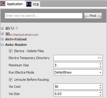

DEX used to use a free version of Electra, you are probably been sent to rut it.
This was withdrawn some time ago and DEX has its own auto router. Under Settings/Applications/Auto_Router there is a checkbox Electra-Delete Files checked on my system. Also Electra Mode = Do Not Show.
So if you stop it trying to use Electra its should use its own inbuilt router.
(Would depend if you have a late enough update that has the native Auto-Route.
Gerry
Just confirmed, if Electra Mode <> Do Not Show it will try to run Electra, which is not free. So set it to Electra Mode = Do Not Show.
Edited 2024-05-31 20:36 by disco4now

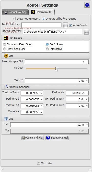

I still can't seem to autoroute.  Here are my settings pages.  I note that I do not have any option tab for Ïnternal Router  on the Router Settings page.  Is there any way around this?

I may have given you incorrect info here. I think I may have the free version of Electra initially distributed with DEX installed and it is just hidden with the settings indicated , but is still actually doing the auto route.
Electra is no longer included or even available as free I think.
I did have the impression Dex has developed it own auto router but this may not be the case.

I do have a working DEMO (free) version of Electra that has always worked since I installed it. I switched to the INTERNAL router as I preferred it (and was testing it) and never switched back to Electra.
I clicked on the pull-down on the route tab and the internal is not there but the Electra one is active.
There is something funny here as the demo Electra, which I believe is no longer available is only valid for 250 pads. My last board has well over that many.

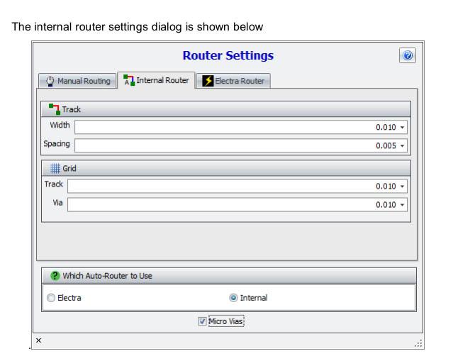

Page 702 of the latest downloadable manual has internal as an option but like SYM-1 I can only see manual or Electra tabs on mine.
Here is a screen shot from the manual, (sorry that doesn't help)

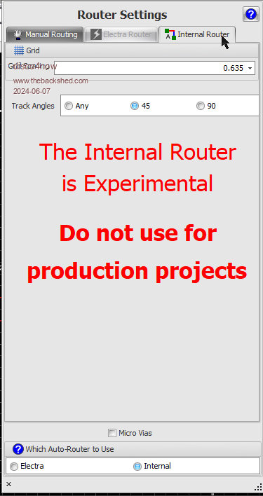

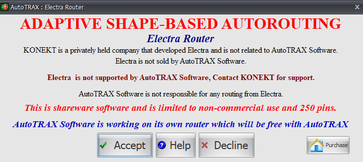

Posts: 6603
Posted: 07:07am 07 Jun 2024
I have a clean copy of DEX that I installed 12 months ago.
No updates since then (Don't use it much!) and now my 12 months has expired.
This is what I saw when I tried to autoroute:
It suggests that he is still intending to provide his own router.

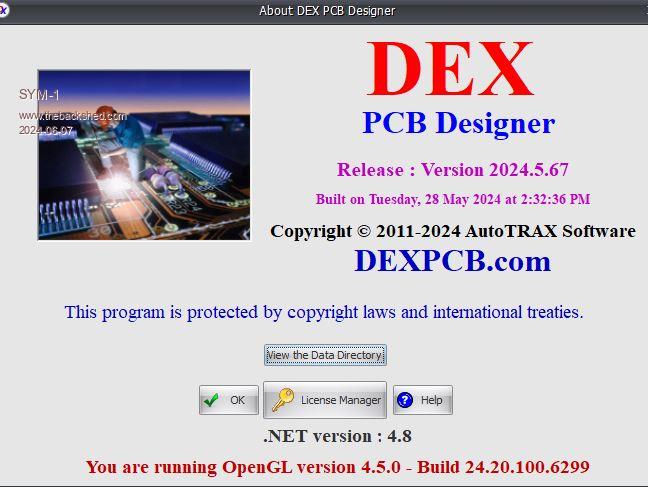

disco4now
Joined: 18/12/2014
Posts: 1151
Posted: 07:54am 07 Jun 2024
This is what I get when selecting Internal Router by  expanding with the little arrow,
mine last updated 27/3/2023.
F4 H7FotSF4xGT

I just un-routed my latest board and tried to re-route it.
The Electra limitation popped up, I have 286 pads on the board, max is 250.
Based on that I guess that I one of the following scenarios occurred in the design process.
I used the Internal router (presumably was active when I designed the board (final save 13-April), I thought I was using.
I started the design when there were less than 250 pads and then added more components manually, (highly likely).
I manually routed the board from scratch (unlikely).
I don't know why the internal router has been removed because it was quite good.

Posts: 2981
Posted: 12:36pm 08 Jun 2024
Hi Sim-1, All,
Download the latest version.
The author said he has reinstated the internal router, but to be aware it IS Experimental at this stage.
It may take a day before the new version is up
Edited 2024-06-08 22:37 by bigmik

He said is is experimental so be wary. And that it hates big pads and pads off grid.
So my suggestion is to keep pads on the grid, I am very guilty of moving off grid to squeeze in another track or add a new part etc.
If you have pads that are large and the Internal router didn’t like them, reduce their size, do the route then resize the pads.
