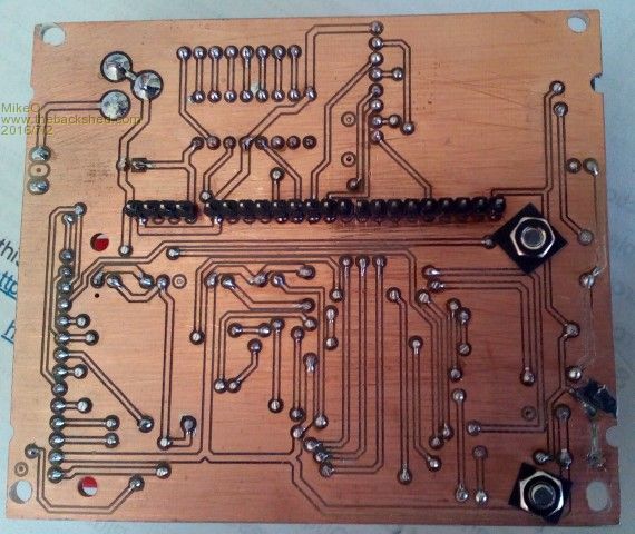

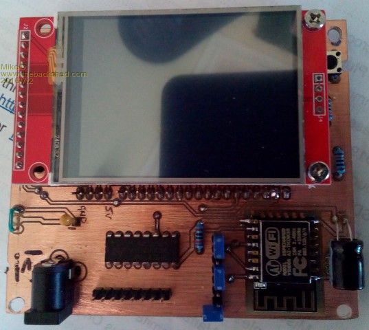

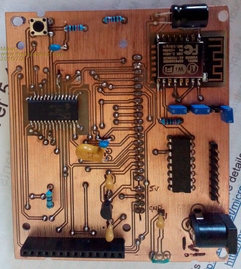

Jim, I missed your post on this as I have a CNC machine and regularly cut boards by isolation milling.
I have a Carving unit basically a 6040 unit with 800 VFD water cooled motor. It seems now that carving have changed their name. I went for this model as it had more substantial drive rails at 20mm.
I purchased a parallel drive unit only because I intended to rebuild it to my own specs and drive card which is USB from a company called Planet-CNC. I have had very good results with the software and can recommend it. I use an XP box.
It has taken me some time to learn some techniques but i am now very happy with the results I am getting.
Cheers Mike

I think you may be quite CAD experienced but I use CamBam for drawing up my milling operations, bezels and enclosures like my latest project , I also did the plastic fabrications for the motor and bearings mounts on the mill.
Here is a couple of shots of isolation milling , you will note I haven't made the move to SMDs yet!
Cheers Mike

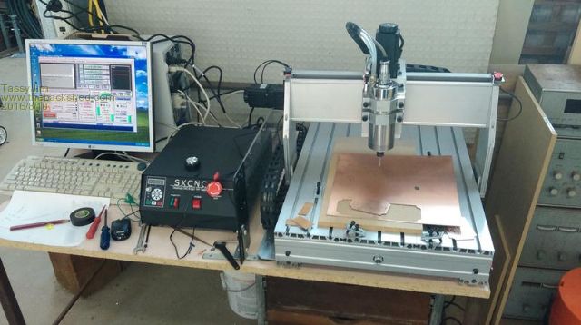

Posted: 05:39pm 04 Aug 2016
I think I was lucky with the machine I ended up with. None of the drama that I have since read about.
I have yet to cut a board but I am getting close.
I use DEX for the PCB design and the CNC files it produces look like they will do the job.
This will save one step in the process.
I am starting with single sided boards and I wrote a program to flip the DEX drill files so I can do that step from the bottom without the need to turn the board over. One less step where disaster can prevail.
I like CamBam for quick bezels etc and for now I am still on the trial version. I leave it running all the time so it will take a while for the 40 starts in demo mode to finish. By then I will know if it is worthwhile purchasing.
Trying to learn DEX, CamBam and Mach3 all at the same time is interesting.
I have limit switches fitted to the mill now so that makes me a bit happier.
I also have a heater in the shed now so that makes me a lot happier

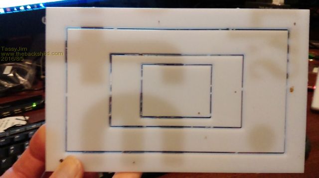

This is a nest of bezels for 7", 4.3" and 2.4" produced on a bit of scrap acrylic sheet.

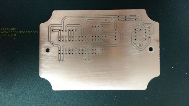

My first (I don't count the first first attempt) PCB
Still a lot to learn.
I used DEX to do the layout. I am having a problem with DEX but I am confident that Iliya will have a solution soon. (A strange bug and I am glad that it's not me that has to fix it)
I wrote a program to flip the drill file so that I can do all the engraving and drilling from the bottom side without having to re-position the board.
AutoLeveller was used to probe the board and compensate for the lack of flatness.
TurboCad followed by CamBam did the board extremities.
There are a couple of areas on the board that needed manual cleanup but, for a first, I am happy.
