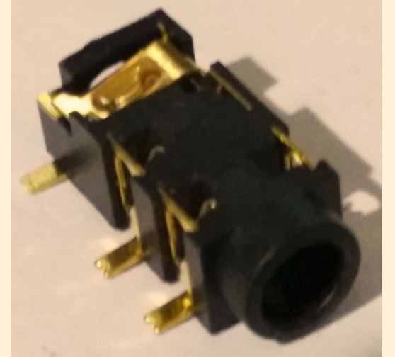

I have received my Headphone sockets form ebay, and have successfully added the part into DEX. Well, almost finished.
The part is a Surface Mount, with two small studs, that need to go into holes underneath the socket, for the PCB Guides.
How do I add these 0.8 mm Diameter holes(2), to the part?
Will keep trying myself, but thought I would ask here.

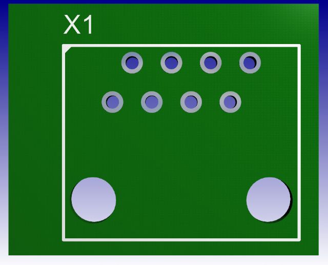

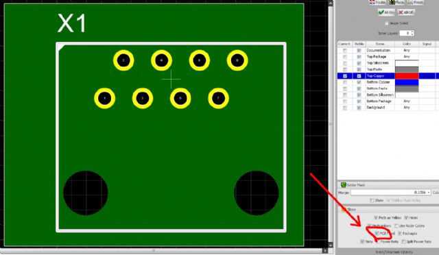

This is a part I created with two mounting holes.
The holes are there in the footprint in the library viewer but do not show on the PCB.
2016-08-27_015615_RJ45.zip

Hi All,
If you select PCB filled the holes will show.
Also you can always check the 3D view

How come these holes need PCB turned on but the mounting holes in my board show up without PCB being on?
At least the layers panel is one that I can use without crashing.
It is b... difficult trying to learn the program when the properties panel and part builder are out of bounds.
Posts: 2981
Posted: 09:47pm 26 Aug 2016
Hi Jim,
I don't know.. Possibly a bug..
Best to create a bug report in the bug reporter as it certainly looks like a minor bug.

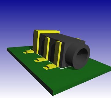

I managed to put holes for the pcb guide, in ok.
Quickly whipped up an stl model to add for the package. Scale was a bit off.
Had to import the stl at 0.0155 scale. Created the model using real world dimensions. Got it to fit eventually.
For Comparison. The Real One.
Thanks again for all of your help.
