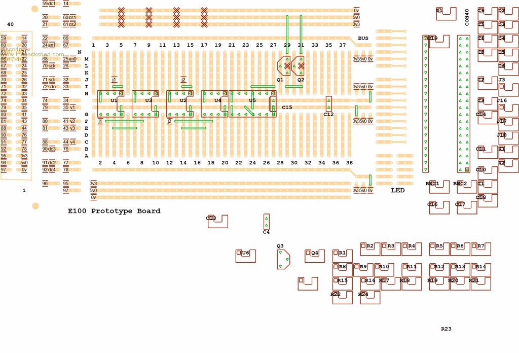

The board editor which allows you to design your own strip boards is also added. e.g. You can build something that looks like the E100 Prototype board or the MUP prototype board as a starting point. This is something I started as an example.Designing the prototype in VeeCAD saves a lot of errors I have found.

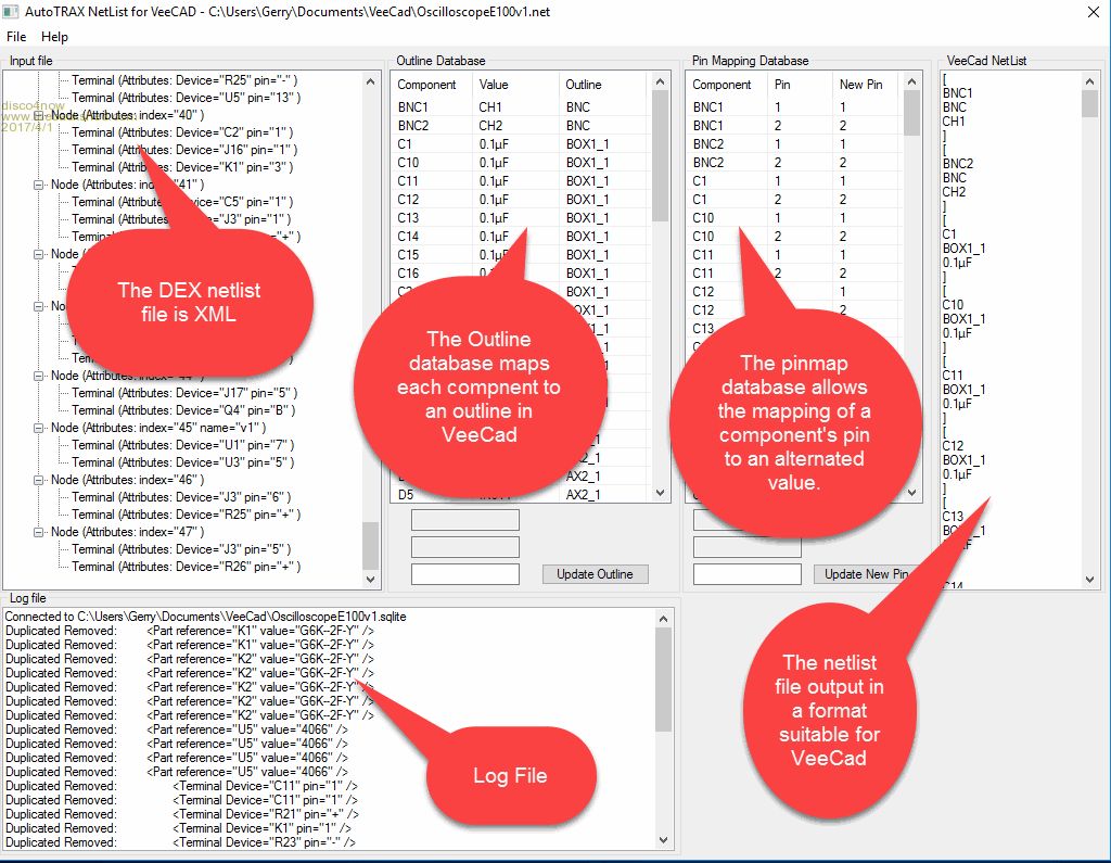

The netlists exported from AutoTRAX are not immediately in a format that can be imported into VeeCAD. The attached file contains a utility that converts the AutoTRAX netlists for use in VeeCAD and adds some useful features that allows mapping of the AutoTRAX components to suitable VeeCAD outlines and the mapping of AutoTRAX pin names to VeeCAD pins where required.
The help file in the attached zip gives more detail on its use.
The utility is written in PureBasic and the source is included as well as the exe file.It is small enough to re-compile in the demo version of PureBasic if required.
Just put the help file and the exe in the same directory and it should run.
A blank VeeCAD board file is included in the zip which contain all the VeeCAD outlines I have added for use from DEX. These need to be opened using VeeCAD.
2017-04-01_025953_DEXVeeCADNetlist.zip
A screen shot of the utility in action.

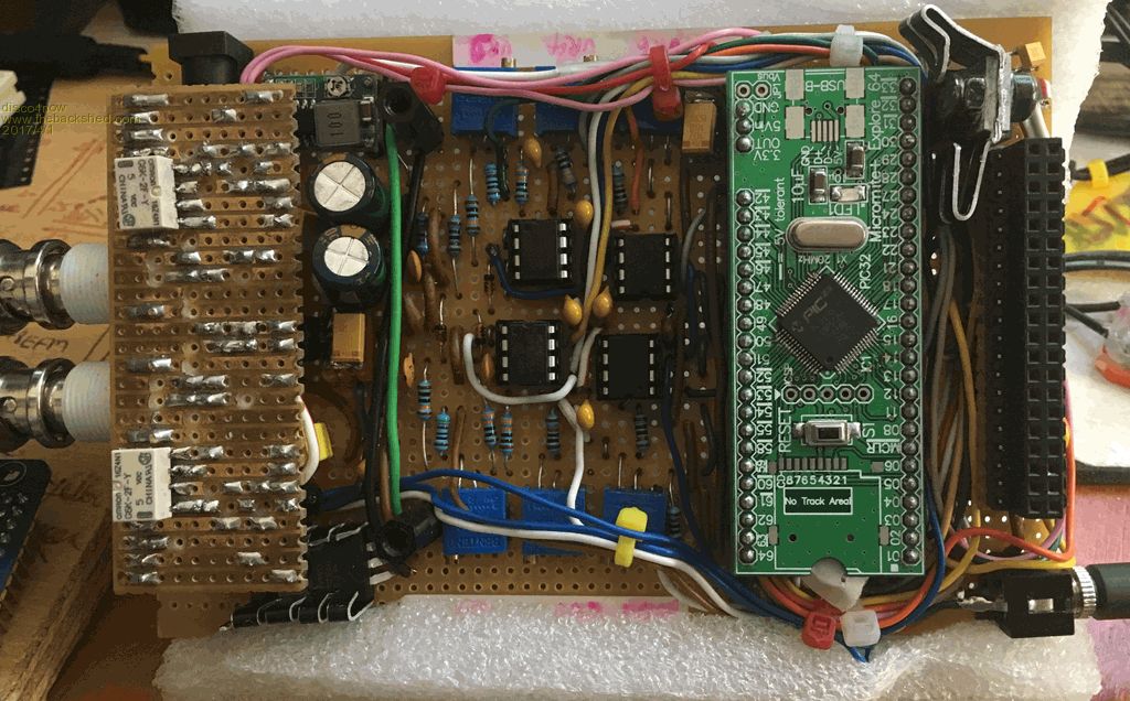

What I have build so far using AutoTRAX for the schematic and VeeCAD to assist with the layout
Its a motherboard for a Explorer 64 and LCD screen that implements an oscilloscope based on Peters previous work. I will post more about that soon?. Its taken quite a while but I think I nearly have something.

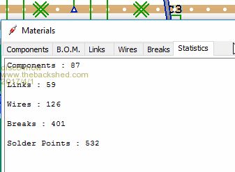

Hope you find it useful. VeeCAD is very powerful/useful when you get to understand it. I can't believe how many mistakes I have made, but think it would be almost impossible without VeeCAD. These stats from VeeCAD show the bits quickly add up.
