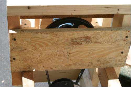

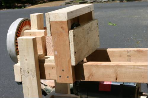

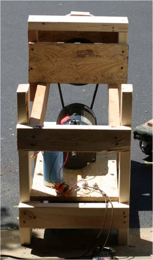

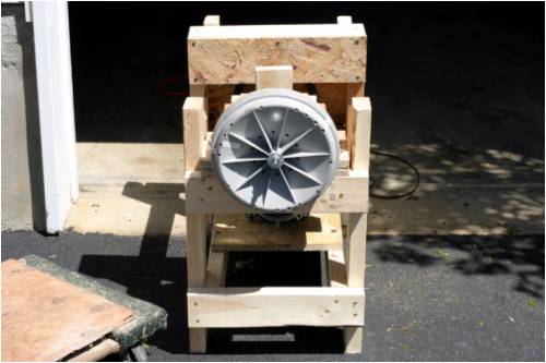

I finished by test bench and it came out really nice. I ran my generator and was able to measure rpm with a meter tied to two of the phases; and, I measured the voltage and current. I will post the graph soon, but it put out 1335w at 700rpm into 75ohms. I am keeping a journal of my work at this location
The bench is solid 2x4 and 2x8 construction. The motor is 1.5hp dc motor. The pulleys give a 2:1 gear reduction. There is a cage to trap the big flywheel in case it comes off. I used two 25A rectifiers to split the AC current so they don't overheat. They each see about 10A when I'm maxed out on my variac to the motor at 140v. Two capacitors filter the rectified voltage. I use a frequency counter on my multimeter connected to two of the phases. 28 hz equals on revolution/second. Two other multimeters measure current and voltage. Graph will follow shortly.
Here are some pictures.

Good work Imsooth , Will be intrested to see the output from 80 to 200 RPM , my dual neo would do 600 to 700 watts at 230 to 270 RPM , but the draw back is the start up and staying running in low winds below 12 klms , I have at present gone back to standard rotors because they will produce all day if wind above 8 klm is there . I have not given up on neos as yet and will continue when I build No 2 windgen and trial a 6 blade prop , they need big power to drive them. Have you totally eliminated clogging ? When I angled the magnets on the hubs I did to have no clogg the out put drops off as well . It looks like you are using the grey plastic rotors , are they distorting yet? , it is a problem i encountered even after the strengthining I did , search post "48v dual neo" for pics of my hubs . Keep up the good work and keep us posted...

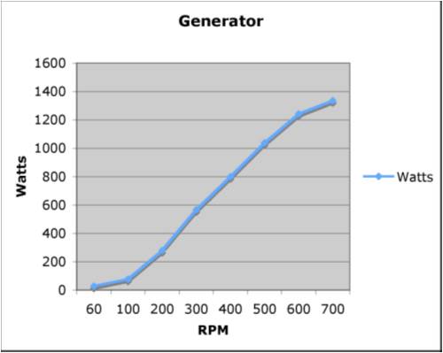

Here is the output graph
I have not noticed any distorting, yet. I designed the magnets to have the
same arc as the rotor so they bond directly onto the metal without any air
gaps. This reinforces the strength. Also, the angle chosen for the
magnets significantly reduced cogging, and, as
you can see, did not reduce the power output.
I am now working on fastening the steel hub to the rotor.
Again, if anyone is interested in purchasing these magnets they need to
let me know and I will call the manufacturer and place an order. You will
have to pay for the magnets and shipping ahead of time; then, I will have
them shipped to your address.Edited by imsmooth 2008-05-15

Great work but I notice you are producing more than your 1.5HP so apparently you are overdriving your motor. Have you measured motor voltage and current when you are getting 1300 watts out?
imsmooth
Joined: 07/02/2008
Posts: 214
Posted: 12:13pm 14 May 2008
Shipping is about $75 from China. I would have to get a quote on the cost per magnet based on the quantity. I originally order 60 pieces (30N, 30S). They fit directly onto the steel backing. I am only testing Star.
Yes, I am overdriving the motor. THe motor's original rating is for 180v/15A (DC). I was running it at 140v/20A (AC) (voltage/current going into the rectifier-filter circuit). I don't have the DC values going in. I only did this for a minute so I wouldn't burn the motor.
