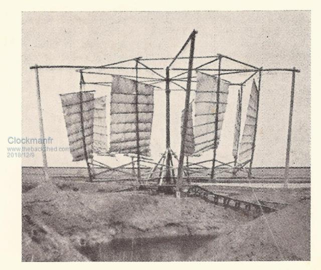

In the early 1980's, I have played with a Chinese's design VAWT that was around 1000BC and had luffing/tacking Junk sailing boat sails. see pic.
Mine was steel construction with a Hydraulic pump operating a big ram with a heavy weight,(Big water tank) that when fully extended operated a switch and realised the energy under gravity to a 2kW generator. My conclusion ...... a lot of work and expenditure and never would get my expenditure retuned, ie it was not a cost effective solution for generating electricity.
