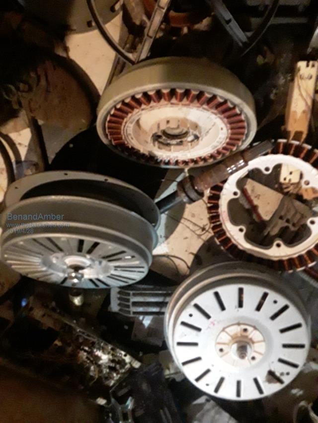

I have a few of these they're not Fisher and Paykel they're the American style of the same thing if anyone needs one of them
They are not for sale they are free besides shipping
to anyone that is serious and will upload their project here for all of us to readEdited by BenandAmber 2019-04-29

The top one is a Fisher & Paykel.
The rest are LG .
Not much work has been done on the LG , but I have a couple ,sort of "under -consideration". They look much stronger than the F&P , the bearings and hub arrangement far stronger .
Oz Engineering (Phill M on this forum) , has done a lot of work on both . It would be wise to look up his posts ,he does really good work.
