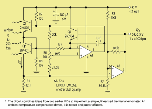

Worse still ... just when you think you have had a half decent idea...... I find this:
This circuit does not look as sexy as those spoons, but is +/- 5% down to 1 foot/min (virtually stagnant air) up to 250 f/min. (1.27 M/S or 4.6 kph or 2.8mph) with the above values.
Just changing values for R1, R2, and R3 takes it up to where ever you want.... sky is the limit.
It is unbelievable that it can measure such tiny air speed so well. Worse still you could build a dozen for a few dollars.
Takes all the fun out of it really

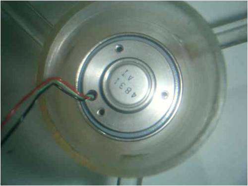

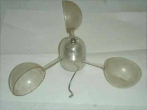

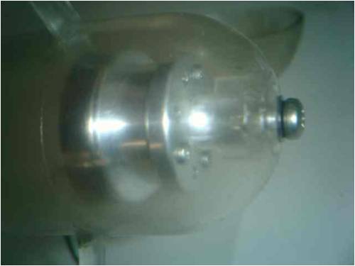

Anyway, this is what I did: I bought a used anemometer vane at a boat trade show. Don't recall the price but I doubt it was more than 1 guilder (ancient obsolete currency; we now have Euros. Price was about 0.50 US$ back then). Installed a simple DC motor in it. Output voltage is then a function of windspeed. All it takes is an analog meter (with a moving needle; anyone remember those ?) and a calibrated scale. Presto. That's what *I* call a simple el-cheapo functional anemometer. Stone-age technology to others, perhaps.
No batteries, no power needed, no opamps, PICs, no logging (I don't need/want logging).
Because of the lousy bearings of that tiny DC motor (which put out about 10 V, so easy to measure) I'm now using a small brushless motor from an old harddisk drive which has ballbearings and doesn't have brushes like the previous motor. It puts out 3-phase voltage, plenty of volts at low RPMs to be easily measurable on a run-of-the-mill analog meter (old VU-meter perhaps ?). The hardest part was making an adapter to mount the anemometer-vane to the motor. Bit of work with the lathe and some work with a file solved that problem.

Dinges, I notice that while you were banging those rocks together, you managed to take time out to build your own electronic spot welder, (instead of the tried and true method of shorting out a few batteries), a micro-resistance measuring device (rather than using the voltage drop with a fixed current and a slide rule) and a dump load that is more complex than the space shuttle to name but a few.
Nice little anemometer you have there, although I am surprised the purist in you allowed you to use an iron cored design (dc motor), followed by another iron cored drive stator in the disk drive motor... (you won't get to heaven this way.... )

Actually, looking at that circuit (1 op amp three trannies and a few resistors, it may be quicker and easier to slap it together, than trying to mount the cups on the motor shaft.
I don't know what the thermal lag time would be for this setup, but should get more responsive as the wind speed gets up (this is idle speculation though). I don't know how fast a to92 responds to air flow thermally.

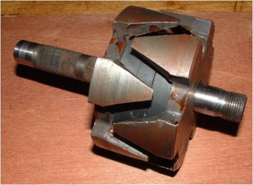

This is a picture from wxyzscience when he did the same thing. At this stage he has not replaced the shaft, but does so shortly as it is pointed out that the flux is getting shortcircuited.
http://www.fieldlines.com/story/2007/7/3/191357/4809
In this instance, the claws set up an alternating pattern of N S N S (however many claw sets there are) So when it spins these fields are constantly changing and cutting the coils around them.
But, steel shaft would short circuit the flux from the north pole to the south pole via itself, and leave very little loose flux to generate anything across the claw gap, as it is easier to make the N to S trip via the steel axle, rather than go out to the claws and jump the air gap.
