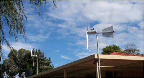

I have a 24 volt 100 watt 6 amp scooter motor. If I connect a 4.5 volt globe to it and spin the shaft by hand it lights the globe. If I attach a 12 volt festoon globe it just gets a glow in the filament. I then mounted it up geared it to around 4-1 and attached a 1.2 metre prop. The prop was spinning extremely fast and I connected a 12 volt globe to the motor and the prop almost stopped dead. I then tried a 3 blade prop with 500mm blades and the same thing happened. Any ideas as to how I can make this work. I have made wind/gens with printer motors and have attached 26 LED's (21 white and 5 flashing red) they work like a charm. I am a newbie so any help would be greatly appreciated.

Hi Marcus - Looking at your picture it is the same motor. The problem I am having is being able to get enough power from the wind to turn the shaft under load. I guess I will have to work out the correct gear ratio to do this, 4-1 ratio wasn't enough. I don't know much at all regarding the electronic side of it, if I can put a prop on it and it lights up a few lights I'm happy,lol.
The pic is of a couple of small gen I have made using printer motors which are 24 volt and put out around 5 volts.
