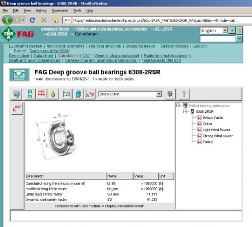

OOh this was fun! I just discovered that there is an on-line calculator on the FAG website.    I put the stats for my machine's service (some numbers off the top of my head). I could fix it up with better numbers once I've sized the prop, settled on the furling speed, etc.
2009-02-06_072909_6308_FAG_Calc_Report.pdf

[quote=Steven]Life is also a factor of cost, so I have FAG's in the GE generator right now.[/quote]
So... you're saying that cheap Chinese bearings are not up to the task, even though they have the right numbers printed on them? (feigns shock)
Yes. And that's the reason I use nothing but SKF. But I wouldn't hesitate to use FAG too. Or NSK. But anything else is a definite no-no.
[quote]My GE conversion is making "noises" and they aren't just wind noises.[/quote]
Hm. But I'm curious: did you install new bearings in that conversion (and if so, what brand), or did you re-use the old ones? And if they were new: how long did they last?
I love those online calculators too (I'm only familiar with the SKF one; or the manual method... ), but they don't tell everything. They don't take environmental factors much into account. And that's one particularly important point in a windturbine. BTW, I think I would have chosen 'influence of ambient' in those calculations not as 'standard', but something a little more conservative ('harsh' or 'severe'). Especially if I were living in Canada...
I notice your 7.5hp uses the same bearing(s?) (6308) as my 10hp (which uses both a 6208 and a 6308, but only because it's the rugged variant of this range of motors; the standard bearing configuration is 2pcs. 6208, both in the driven and non-driven end...). So in that respect your conversion will be more rugged than mine.

[quote=Dinges]...using online calculators is cheating...[/quote]
In my defense, I have under my belt several work projects (before the time on on-line calculators) to validate the use of new bearings in some extremely punishing environments. Ever been tasked with selecting new bearing for an oil cooler blower fan mounted in a transport helicopter? The lesson from that one was that you don't start such projects when the customer expects the replacement bearing to be CHEAPER than the OEM bearing, yet last longer!
As for my own environment, I didn't spend enough time with the calculator yet to try different temperature ranges. Indeed, the noise I report only happens below -25 Celsius, so I shouldn't have been using spring/fall temperatures in the calculator.
The GE motor got a fresh set of FAG bearings, so rest assured. I don't remember the sizes off the top of my head. The Toshi is still using its old bearings, but changing them is on the to-do list. The Toshi's bearings are 6308-front and 6208-back. I will pick up some SKF or FAG when the time comes.
