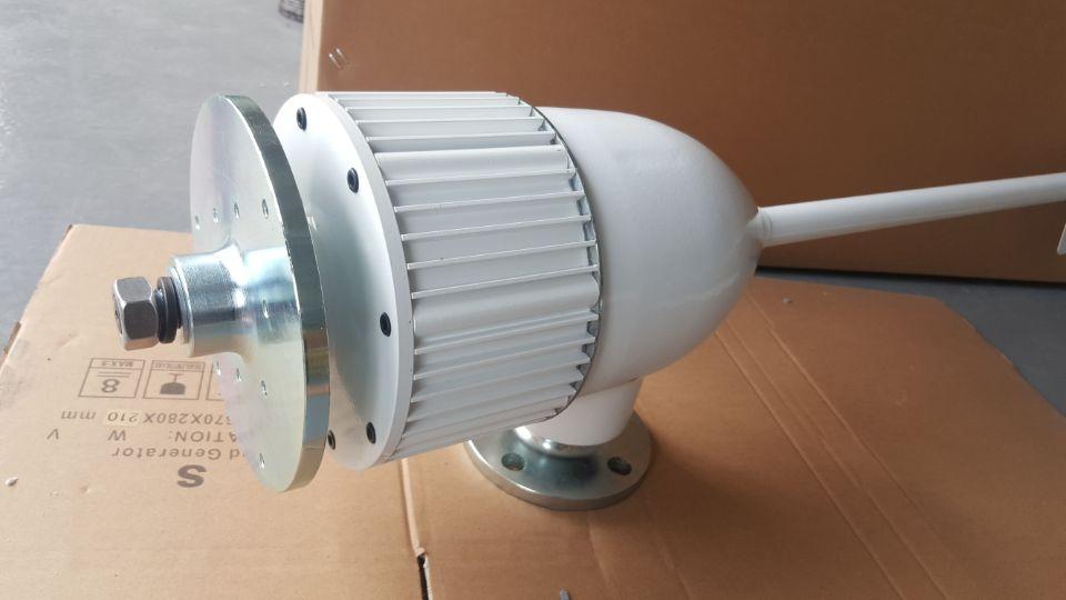

Technophiliac
Joined: 18/12/2020
Posts: 92
Posted: 11:02pm 24 Oct 2021
  Davo99 said  I would suggest the chances of getting over 500w from your turbine is minimal.
Maybe author is right - and I waste a lot of time and resource on this.
Hmmm. I better test.
Using a Hitachi 620W drill on low speed (1100rpm no load) it ran up to 444 rpm (measured by controller). Had to hold drill with both hands!
Max current generated was 22.21 Amps. Max Watts were 338W. (= 15.21V) But actual voltage climbed to over 16 Volts using reasonably charged SLA 12V batteries in parallel summed to 144 Ahr. (Current and watts measured using Jaycar 200A Digital meter.)
Something smelled. Realised it was the drill smelling! Part of drill body found very hot. Drill rpm maxed at 444 but quickly dropped to 415 rpm. Ran 3 bursts with the drill total of 2.27 mins with cooling down time on between.
Turbine is rated at 650 rpm which I could not achieve and was miles away from.
338W at 440rpm, bearing in mind typical power curve, what will it be at 650 rpm?
My expectations the turbine is a true 800W turbine remain to proved - and particularly disproved.
To my mind this test does not disprove the turbine is a true 800W unit and supports it probably is.
The extent the circuitry behind it plainly needs to cope with 800W - and more.

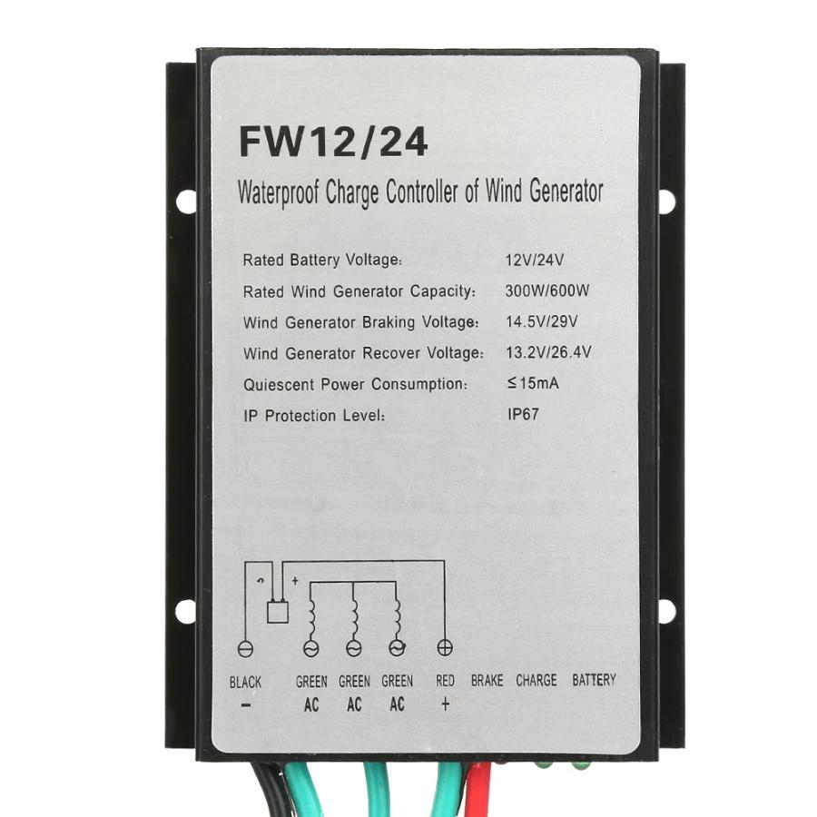

Off grid man caver
Technophiliac
Joined: 18/12/2020
Posts: 92
Posted: 05:09am 25 Oct 2021
  pollenface said
  Technophiliac said
  pollenface said  I have the 1000w boost/mppt controller from ebay $65AUD.
It works, but my turbine has never produced more than 225w in a single instance.
Would you please advise the brands and model numbers or give url's?
Here you go
https://tinyurl.com/37j8u46t
Thanks for your suggestion of "Wind Turbine Charge Controller Waterproof 40A Voltage Boost Low Speed Regulator" - 12/24V. 12V @40A = 480W. Not going to cut it.
Maybe two PWM in parallel might work?

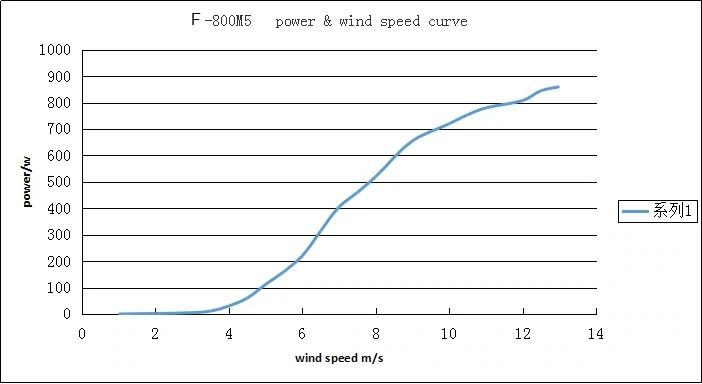

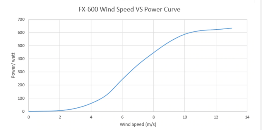

Technophiliac
Joined: 18/12/2020
Posts: 92
Posted: 07:30am 25 Oct 2021
Efficiency? Hmmm Apparently the power is the cube of the wind velocity. Ref (https://windexchange.energy.gov/small-wind-guidebook.pdf
The manufacturers graph suggests I'll get 340W in ~6.5 m/s wind. If that is correct, for my location I do not see efficiency as a priority issue, given we get winds that at times average 10 m/s / gusting 20 m/s - Do I need to worry about efficiency?
I consider I need to be more concerned about managing the power and turbine!
If I'd realised at the time of ordering the 12 V turbine the controller was going to be an issue I might have been better to have gone with 24 V. Benefit of hind sight! I've got the 12V version, will go with that if I can as I've been running a 12V bank / test system.
