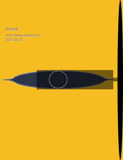

  kitestrings said  Then there is tower shadow.  The wind is now going through the tower to get to the blades which cause uneven loading on the rotor, and possible noise.
Ah yeah, I never thought about the tower interference.
Shape the tower profile like this.
Just from the nacelle down to the length equalling the rotor's radius. More like a skirt of fabricated sheet metal that goes over the tower, and yaws with the turbine, as it follows the wind direction. Making the air pass around the profile with more laminar flow.
