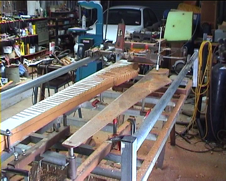

making identical blades quickly is always a challenge for me so this carving jig made from bits of left overs solves the problem
Posted: 09:44pm 22 Mar 2006
Nice.
I've heard about blade copy machines but never seen one. It sure would make life easier.
Thats a nice looking blade there too, how long is it?

Posted: 12:14pm 23 Mar 2006
thanks Glenn, its 1800mm long 1/4 cut douglas fir
