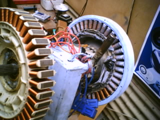

hi got 2 f/ps on 1 shaft mounted at each end have attached prop to magnetic ring for 2 years now with out any problems but the double buzzes a bit.
 i helped it to be quieter by rubber between stater and rubber hose around screws then rubber then washers, and then affix lead weight about same size as ruler on outside or the starter attached to prop helps but still want it quieter ,is totally silent when front stater is removed , have had same prob on 2 mills ,strangely still buzzes when power plug is unplugged. so gess the blades are acting like speeker cone and magnets going past iron are the trigger?
any fellow nerds got any practical suggestions on reducing noise . like deadener,weight or water to absorb noise ?

Hey, I might have the correct notion as to what is causing the buzzing, but fixing the buzz is another issue. You may have eddy currents in the steel laminated core. Ideally, the laminations are electrically insulated from each other, to minimize wasted energy in eddy current flow. However, due to sloppy manufacture, age, or whatever, there may be electrical connection between the laminations, causing a large induced current to flow inside the magnetic structure of the stator. On the other hand, you might just have some shorts in the windings around the stator poles. You can use a primitive magnetic AC device called a "growler" (in the states) and a hacksaw blade to rapidly detect shorts in the stator windings. Once you figure out the nature of the short, then you can decide how to fix the problem. I would definitely try the growler first, as you might only have to rewind a couple of the poles. Hope that helps, and thanks for the picture. (I love this website!!!)
