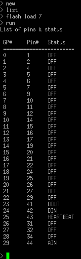

Hello everybody,
this morning I wrote a tiny programm to list all the pico GPnn pins together with their physical pin number and status.
I couldn't figure out how to generate to 2nd parameter ("GPnn") of the mm.info$(PINNO GPnn) structure, so i simply repeated the lines and changed the "nn" manually. It's ugly but it works ;)
Here is the listing of pinlister.bas and the output in a picture. I used mm.ver 5.070515 for testing.
I saved this as flash 7 so I can quickly look up the values by a 'flash load 7' & run.
Print "List of pins & status"

-andreas
