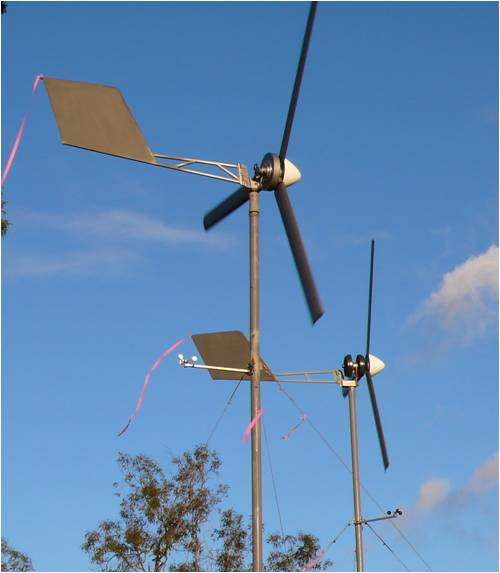

I now have the two mills up and flying as you can see in the pic above , I was origionally going to title this thread as " The Ax Fx - Vs - F&P Dual " but decided to not pit one against the other as they are two entirely different machines with completly different costs and engineering involved in construction..
I would rather just give the basic data and details of what the two machines are doing in output and performance and anyone who reads this can make their own conclusions on what path they would like to go on ..
Firstly both mills are setup for a 48V system as all my power goes back into the Grid via a Latronics PVE 1200 .
The basic concept for the Ax Fx was worked out by Gordon and is specificly designed to have a cut in of arround 200 Rpm and uses a Capacitor bank and Voltage doubler arangment to allow a cut in of 100Rpm , the blades are 3.25m and are the PVC evtrusions available through the links on this site, if more info on the way it was all built and assembled then search for Homegrown Ax Fx ..
The F&P Dual has been a work in progress over the last two years with many different changes to get to where it is today , the stators are 80s configured as 2p7s and both have been declogged bu twisting the poles , they . One in star and one in delta , both with their own cap banks and seperate voltage doublers that give a cut in of 100Rpm (star) 150Rpm (delta) , the blades are 3.15m and the same PVC extusion. I dont think it can get much better than where it is at present ,
The F&P starts up in arround 8klm and will produce power in anything over 6-7klm and in wind up to approx 15klm there is almost no difference in output , but the Ax Fx doesn't stop unless the wind stops and is ready to catch any available power while the F&P is still getting up to cut in speed , that is the big light wind difference . Between 8 to15 so far the F&P seemes to be a slightly better in output and then it all changes as the wind keeps increasing as you can see from the piclog max readings below..

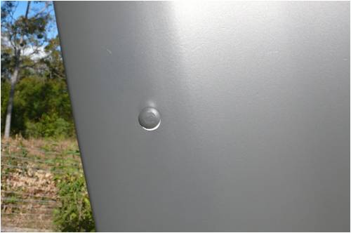

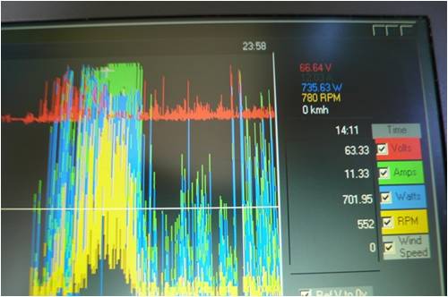

Where it all gets pear shaped with the F&P if you dont have your furling set up properly is after 500Rpm where the core becomes saturated and the torque curve is droping and there is basicly very little additional power that can be produced with out getting into a dangerous situation as in an out of controll wind mill as happened here as you can see 750Rpm @ 735W in 50+Klm . The F&P can not be stoped by shorting the coils in this wind only a mechanical brake would stop it or worse still, total destruction.. All in all a pretty good test for the PVC blades with concerns from some that they can't get up to high speed .. I have now increased the offset and it is furling in 35Klm as I don't want this happening again as shown in a pic of what was starting to happen to the rivit holes holding the blades to the tubes..

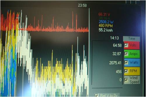

The max read outs for the Ax Fx speak for themselves 2500W @ 480Rpm in the same 50+Klm , the point where it was all getting out of controll with the grid inverter maxed the dump load maxed and batt voltage still rising , the switch was thrown and it stopped .

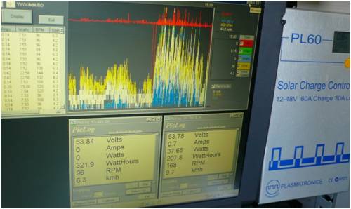

Dual piclog , reading both mills at the same time .

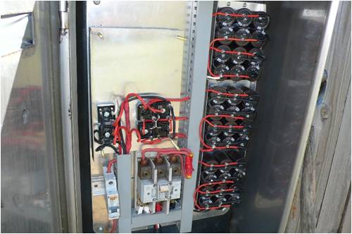

Elec box for the Ax Fx

My main concern next is to re-design the tail , longer and to double the surface area and keep the weight the same . I am loosing so much power from the blades not being square to the low to medium wind , this could be one of the draw backs with such a wide cord at the tip as it exerts a lot more thrust through the offset in these conditions . I would guess at a 20 to 30% loss and it's really bugging me hence the streamers all over the place in the photos....Phill
