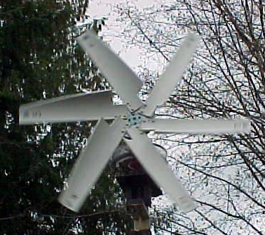

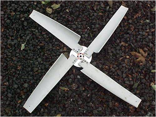

Pic1 - 8" sched40 PVC blades, quartered.
I didn't round the leading edges. Will probably do that next.

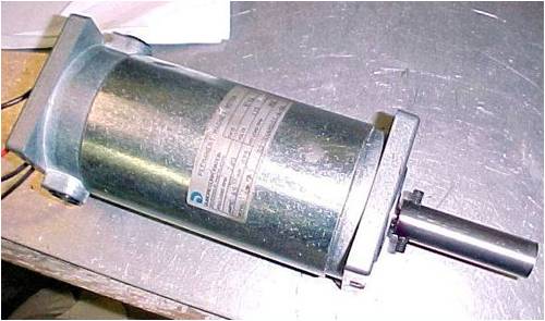

Pic2 - Motor: 130vdc, PM.
Being direct drive, I may be expecting more RPMs than what is possible.

Pic3- The mill with the 6-blade configuration.

Hi Rich. It would be good to know what rpm that 130 volts is rated at. Should be printed on the motor. That will give you a decent idea what rpm your rotor needs to turn at in order to hit your charging voltage (probably 13.5 volts). Once you know this you can size the blades correctly. I think the best trend would be to go with a smaller diameter, thin bladed, 3 blade setup.

It would seem that your generator was designed to operate (as a motor?) at a much faster speed than your mill can drive it. One clue to this is its diameter, which looks relatively small from your pics. I also note that you are only seeing it produce about 4-5 V when driven by your mill (presumably in low winds).

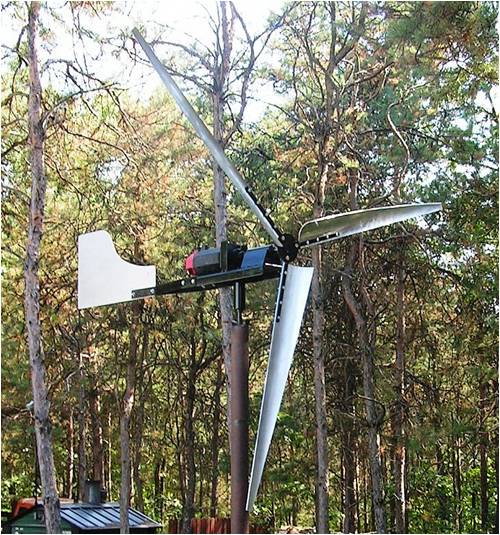

Newbie here with a little test and tune insight regarding this thread. I had the same problem I ended up with a good compromise with the blade design below.
I cut from 12" diameter tubing into six blades (3 for each of my 2 towers. The tips need to run off into a narrow and very minimum pitch to achieve good rpm. I am running Fanuc servo's @ 35amp dc (real time output) with this blade design. I am not a tech wiz at blade pitch hence I had a few outright failures but the current blade I am using works terrific (thank you wind god). I can easily get 200rpm and up (sometimes scary sounding) under full load at about 10-15 mph wind. I have even ruthlessly short the three legs from my motor at high rotation during good wind and it barely slowed it down. It just kept cranking.
Well all said; someone here may have a good tech explanation but take a look at my set up. It may give you some insight.
Blades: 4ft
Overall dia: 9ft
Blade tip width 1.250"
Cut from 12"dia tubing (don’t know what pitch this makes)
