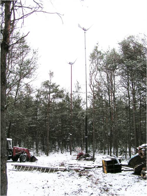

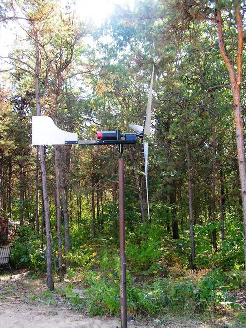

Been looking for a site that is dedicated to home wind power. I just recently finished my second tower 12-4-09 using GE Fanuc servo motors and they work great. Hope to learn a few thinks from the grey hairs and the ambitious people of this site.

nice looking mills! Is that a straight shaft? It looks as if you set the motor back to even the weight on the upright?

  readyakira said   nice looking mills! Is that a straight shaft? It looks as if you set the motor back to even the weight on the upright?
I was concerned that the axial torque of the blades might be too hard on the servo bearings so I made a bearing block and shaft and coupled the servo. I am close to the shore line of lake michigan and wind gust can be quite harsh.

Posted: 07:54pm 08 Dec 2009
Here’s another pic of my towers. I designed them to break down for ease of service. I used boat/crank type wenches. Works great.

Posted: 12:20am 09 Dec 2009
  Dupa said   Here’s another pic of my towers. I designed them to break down for ease of service. I used boat/crank type wenches. Works great.
wenches

dupa-
job well done!
i have a fanuc mill that is close to being done. wich motor of theirs are you using? do you have any max power figures yet? 12 volt, 24 volt? blade size? sorry so many questions.
the one i found is a 2000 rpm 20 amp 140 volt 3 phase. about 50 lbs.

Bearings in those things should be tough as nails,
are those the windgrabber blades??
Welcome, I too envy the towers more detail please

Posted: 12:59pm 09 Dec 2009
  KarlJ said   Bearings in those things should be tough as nails,
Karl
I made the blades myself out of aluminum tubing.

Dupa
Joined: 09/12/2009
Posts: 27
Posted: 01:09pm 09 Dec 2009
  birdhouse said   dupa-
job well done!
have yet to see a fanuc mill in the air so this is really exciting for me! (aka i need to get my butt in gear!)
grew up in grand rapids michigan and will be home over christmas. are you near there?
birdhouse
Hello Birdhouse
My Fanucs are 15 amp 1500 rpm 3ph. I tested them by connecting to a radial arm drill in our tool room. I could generate 120v accross 2 legs at 200 rpm. I currently get 20amps dc per unit(connected to a bridge rect) at 115rpm using an 9ft diameter blade cut from 12inch diameter aluminum tubing. They seem to flat line at 35amp load meaning no matter how much faster they spin the amps do not go higher thann 35. Im sure there is some tech explination for it (over my head). I have 4 more larger units I will be working on this spring.

Posted: 02:51am 10 Dec 2009
dupa/karl-
i think the bearings in these motors are pretty beefy. i went with the blades atached directly to the shaft via a custom hub. hopefully they stand the test of time.
35 amps @ 12 volt?? 420 watts?
what is the voltage on the motor label? i'm guessing it is one of the 198 or 184 volt models.
thats geat to hear you are seeing more amps than the label rating! gives me higher hopes for my mill!

Posted: 12:48pm 10 Dec 2009
I will crank one of the towers back down and get you a pic of the motor label. I can’t remember exactly what the specs were. You mention how beefy the bearings are in the motors. My next tower I may just connect my hub direct as I have found that when my first tower went up it took about a week for the new bearings I installed in my bearing block to loosen up enough to get rotation start at low breeze. It was confirmed that the slightest bearing friction can be significant when my second tower when up and I noticed the first tower was spinning at the slightest puff of wind and the second would not get going until more substantial wind picked up. The second tower has been getting better now that the bearings are wearing in.
All said; just adding a bearing is enough friction to make a big difference in rotation start. Connecting directly to the motor shaft could be a more efficient design.
