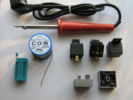

I bought few things for my F&P

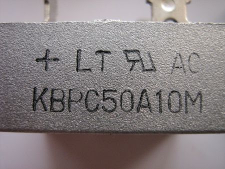

I hope 10M mean 100V not 10V
Now I am ready for the conversion of F&P.

Hi Vasi,
I looked at what you have bought. Seems that the bridge rectifier is 50A 1000V.
Also, from an Aussie point of view, you do not seem to have bought anything to celebrate with!! The job would not be completely commisioned at the end.

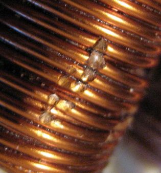

I started with 80 series F&P, cleaned up and found a transportation problem on a coil:
The wire is not cut, I can continue with that or rewire ?
Is the first coil on a group of two poles (in reconfiguring sense). Edited by vasi 2007-08-03

The top 3 are looking
1. If one wire is connected to the wire next to it (shorted turns) you need to fix that by insulating.
2. If the wire is partly cut through that will add resistance and get hoter there. It realy depends how much current is or should be flowing in that wire if it makes a noticable difference.

Ok, thank you, I will put 80 type F&P on a shelf until get 0.8mm wire (good occasion to see how many turns on one coil) and continue with 100 type. One will be on a windmill and another on a pedal generator, as an insurance (protecting batt's when no wind).

Hi Vasi
If it was me I would unwrap that top layer and fill those notches with solder then put new varnish around the repairs and wind it back on.
I dont really think you would loose any significant current handling and besides you could always look at these notches as some sort of weak link fuse.

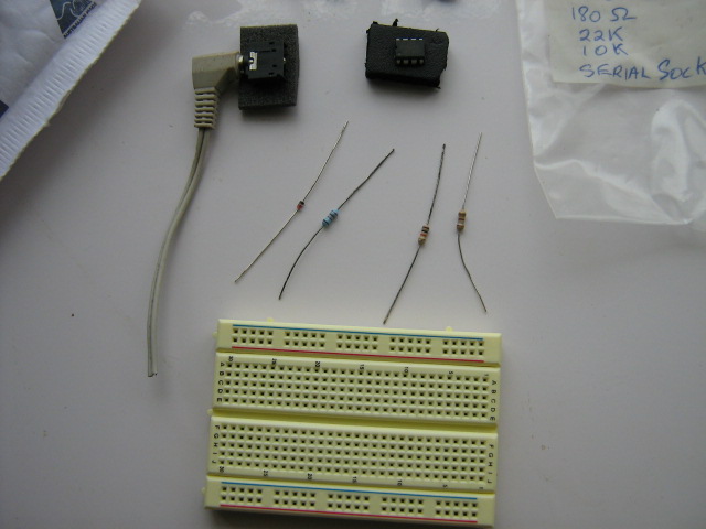

I finished my picaxe windmill controller with car battery setup.
Entire story in english is here:
http://funlw65.googlepages.com/e_picaxe08m_eng.html
Elvish name: Mablung Miriel
Beyound Arduino Lang
Posted: 03:15am 05 Oct 2007
Excellent work Vasi, well done.
And thanks for the plugs
Looks like you've got the hang of the PicAxe chips, good fun once you get started.
I've tried using the toner transfer methode in the past too, works OK but like you say you need to touch it up with a marker pen in some places.
