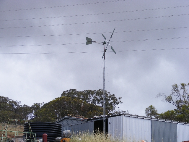

Hiya Guy's,
Well after a hard weekends work I finally got the new genny up and flying. It was blowing a gale for the last 2 days and wouldn't ya know it, no sooner the genny went up the wind stopped. But it didnt take long for the genny to get going . As my batteries were sitting on 27 volts already the genny was going like the clappers just to reach charging voltage. So my next project is making a 1:2 stepup drive and I reckon the plywood blades will have the grunt to get it going.
The tower is made from the inner section of my comms tower and the outer section will become a second tower after I make a new inner section and be around 16 metres high. The one above is about 8.5 metres high.
Cheers Bryan
Posted: 09:07pm 28 Oct 2007
Looks good Bryan.
Whats the diameter of the turbine?

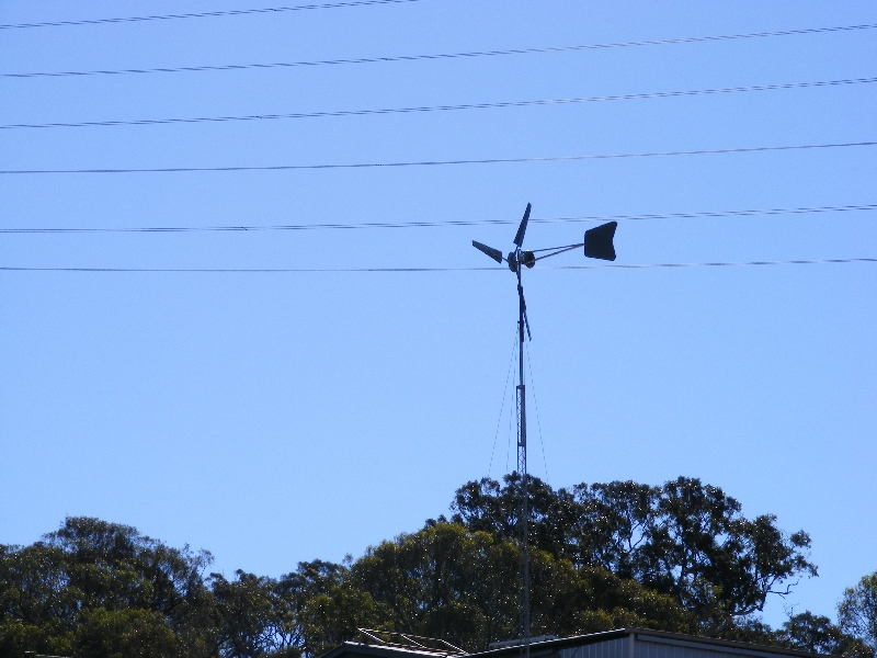

Hiya guys,
Well after abit of work I got thw wind genny backup again. This time I've gone with 3 blades @2.6 metres diameter. Bloody murhpy was around again there was no wind at all so I set the blades up outside to paint and balance them then the wind started blowing and the blades kept wanting to take off. Unlike the 4 blade setup I needed to balance this one which was abit of fun. Anyway below is a pic of it and hopefully it will last abit longer than the previous one.
In a light wind I was getting around 12-14 volts AC so I reckon once we get some decent wind the genny will be charging the batteries way quicker than the 3 metre 4 blade setup but time will tell.
Cheers Bryan

Hi Bryan
L am just wondering about that high voltage power line that showing on this picture ???
Dwyer the bushman
Bryan1
Joined: 22/02/2006
Posts: 2297
Posted: 09:39am 12 Nov 2007
  dwyer said   Hi Bryan
Dwyer the bushman
Those high voltage lines are the main interstate ones, I've got 2 seperate lines near me, 1 going over the farm the other over the neighbours property but no grid connection. The picture is a bit misleading as those lines are over 300 metres away. My goal is after I get a few wind gennies up is when the etsa blokes come onto the farm to check the towers and see them when they ask what I do with the power off them I'll just smile and tell them the spare 5Kw just goes to heating water.
Cheers Bryan
