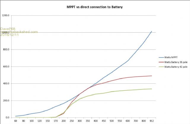

For those who may have seen my graph on how portly an F&P stator performs when directly connected to batteries. I've found an MPPT charge controller that has an input range of 50 - 500V (10 to 1) with charge output in 48V battery system.
This is achieved through 'Load Adaptive Impedance Matching' for maximum energy utilization from the wind turbine.
To put this in simple terms. No one should ever directly try to charge a flat 12V battery from a 24V battery! There will be so much current flowing, very high potential of an explosive outcome...
The controller I found is admittedly a high voltage version, but my point is they exist and input range is 10 to 1 which is ideal. Exactly what a wind turbines want to see electrically.

What Downwind wrote re "a device with a 10 to 1 ratio will give more output power than a direct ratio of 1:1" is not understanding how the F&P stators are designed to perform. They are what they are, not a poor design as previously stated.
Trying for a 1:1 system, knowing that there are whole lot of other variables i.e. wind speed, stator operating voltage over wide RPM range etc etc.
Wind under any conditions is variable, so take an average day say 2.5 - 10 m/s, that's a 4 to 1 ratio. With the cubed law of power output over that same range added in that becomes 64 to 1 under ideal conditions looses excluded.
The F&P stator |(ALL types) have a very dynamic output voltage range of more than 10:1 with a flatter current curve when used under correct operating conditions.
When directly feeding into batteries a higher cut in RPM is required before any current can be extracted at all.
Please refer to this graph with MPPT results speaking for themselves...

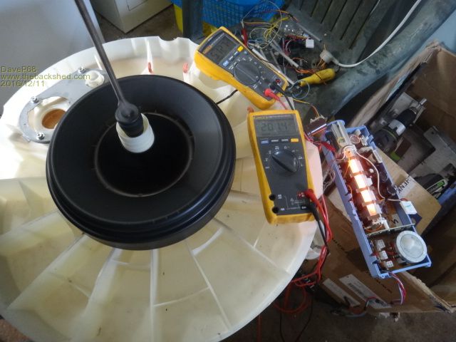

For those interested, below is a photo of my test set up with Fluke Multimeters + Electronics (Modified F&P Phase 2 Blue Motor Controller). Results recorded were loaded into a table to create the above MPPT graph. Stator 36 pole wired 2x6p Delta with Black rotor cap.
Fluke multimeters are showing 201.4V & 5.127A DC respectively giving a peak power output of 1.032 kW @ 912 RPM, so 1000 W can be extracted below 1000 RPM...Edited by DaveP68 2016-12-12
