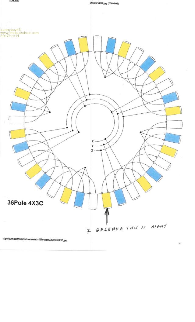

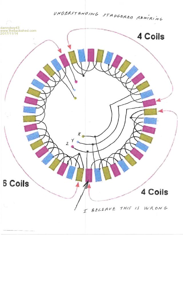

My 42 ploe / 80 /0.8mm wire. In the area of (Understanding Staggered Stators), there are 3 diagrams that of 2X7C, 1X9C 1X5C, 2X7C, and 1X6C 2X4C. As you know these are all 42 pole. They are wired using left side of red blue and yellow, going to Z, Y, and X. That is the total opposite of all that I see in all of the 36 ploe ( 2X6C, 6X2C, 3X4C, 6x2C, and last 4X3C.
Please help me understand what I'm up against. Could it be I have the wrong 42 pole for the lay-out of my choice. Or are the lay-outs made in error, I hope I'm wrong on that point!
I am just worried as to why the 36 pole and the 42 pole connecting to Z,Y,& X are different? Hoping to start right to end up right.

HI: I had a feeling that this was out side the norm. If you would look at the Wind power format that of ( understanding staggered stator's) F&P stator rewiring, the first 3 terminal (poles) going to Z Y and X are different starting points then that of the 3-4 diagrams understanding staggered rewiring are. Even if you look at a F&P factory wiring, you will see the images, the one's I'm making reference to are back-word of all the rest. ? is this, as the images shows the proper way to start the rewiring s or is it a typo?
I feel bad that I didn't make mention that they are aLL F&P STATOR's
Here's hoping that these 2 images will draw your attention to my query
Kind regards: Dan Mazurek

Yea I think I see what you mean, if it is the wire positions on the coils as the start and finish of 1 coil then yes the top 2 are wrong , the finish or end of the coil comes of on the left in reality if facing it and its pointing to you .
