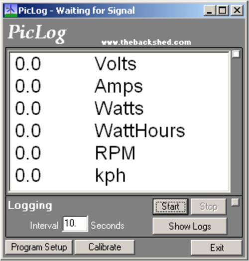

Gill
Joined: 11/11/2006
Posts: 669
Posted: 10:09am 18 Apr 2008
This site has the PicLog that you can make yourself. The site shows pics of the old PicLog program, but the current one logs: Battery Voltage, Amps, Watts, Watt/Hours, RPM, and Wind Speed. What more could a bloke need?
