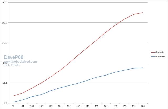

The aim of this topic to show how the efficiency of an F&P stator in different modes and over an RPM range translating to the most common wind conditions (3 – 8 m/s). This was to evaluate the difference between using MPPT (GTI) vs directly charging a Battery.

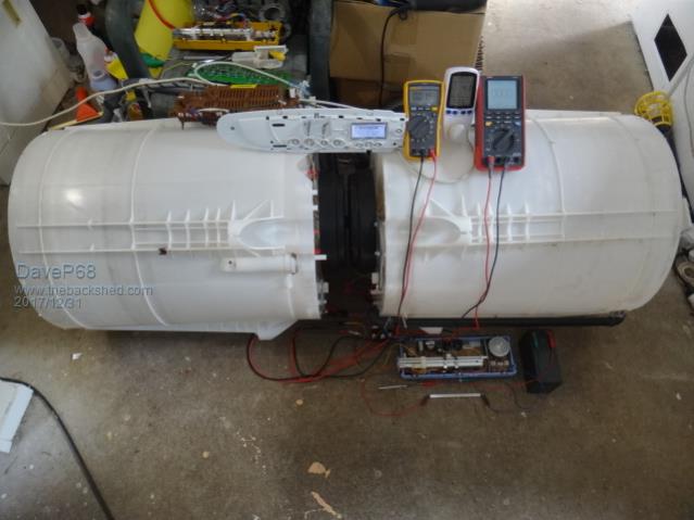

Here is my new test rig with a fully adjustable load (blue module below) that can simulate MPPT (GTI) or Battery Charging.

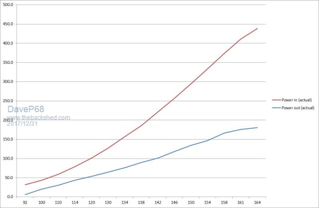

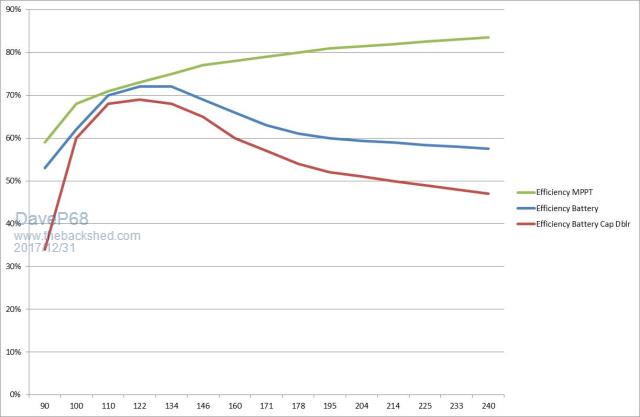

Here is a graph of an F&P stator’s efficiency in 3 different modes, MPPT (GTI), Battery Charging and Battery charging using a Capacitor Doubler.
Have also taken into account the various losses such as efficiency off motor controller, friction, I^R copper loss etc.

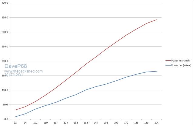

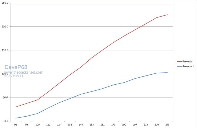

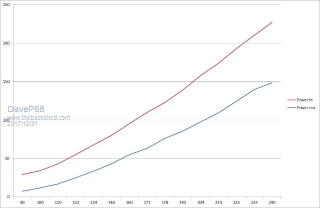

Here are 3 graphs of input power vs output power measured over similar RPM ranges. The motor controller used to drive stator # 1 as a motor is torque limited above 270 RPM so there is no data for above that RPM limit. It also closely represents the winds in a range of 3 – 8 m/s.
My data logger was to take a video of each test from 92 up to 245 RPM and enter all the 4 readings displayed as they updated. Readings taken were RPM (white display module), AC power meter measuring input to motor controller, then Volts + Apms on stator #2 output at DC side of 3 phase rectifier.
First is a graph of simulated MPPT (GTI) which results in the best overall efficiency up to 245 RPM.
Second is a graph of simulated Batter Charging.
Third is a graph of simulated Battery Charging but this time using a capacitor doubler.
** Please note in last 2 graphs, only half of a stator (1x 6c) was used on the output side. The motor torque required to drive a whole stator was almost double as the stator output current approached it's maximum limit due to stator voltage being clamped in battery charging mode. This allowed for a more equal comparison between the different set ups as the input drive torque requirement remained fairly constant over a similar RPM range for each test done.
So the conclusion I've reached here is Battery Charging quickly becomes less efficient as the RPM increases just above the cut in. The MPPT (GTI) system is more complex to impediment, but is the most efficient way to extract power from an F&P stator or any PMA for that matter.
Comparing 2 identical F&P dual wind turbines, one using MPPT (GTI) and the other Battery Charging, the accumulated output power difference over time would be >30 % better using MPPT (GTI).

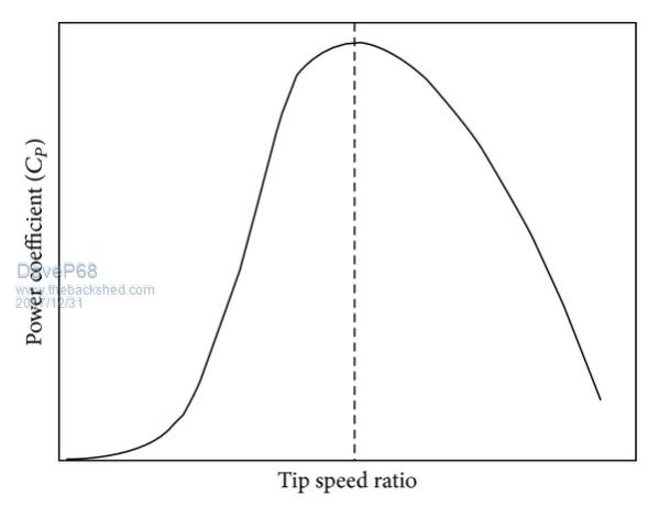

It's all about keeping the blades in the TSR sweet spot in order to gain the "optimum" amount of torque for a given wind speed. Power = Torque x RPM divided by 9.549297 with Power in Watts, Torque in Nm. This is how MPPT works, it keeps the TSR at a point as close as possible to the best Power Coefficient over a wide range of wind speeds.
If too much torque is taken from the shaft then the TSR will drop off creating further losses. The blades will produce more torque at that lower RPM but but at the expense of a lower Power Coefficient, thus resulting in lower power transfer to the PMA. The PMA having less RPM to work with will produce less power output, a law of diminishing returns!!
Here are graphs of the full stator tests when simulating Battery Charging including with a Capacitor Doubler.
Note the much higher input power required at a much lower RPM for not much extra output power from the stator. When coupled to blades on a wind turbine these configurations will be on the downside of the optimum TSR operating range only making the accumulated power output even worse!!
Hope this is of interest for those wanting to build an F&P wind turbine.Edited by DaveP68 2018-01-01

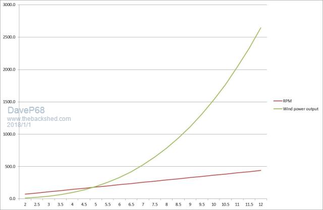

The most important factor in matching wind turbine blades with any PMA (F&P stators in this case) is to keep the RPM generated by the blades in their TSR sweet spot. Not easy to accomplish, as the shaft RPM must remain linear with wind speed and the power that the PMA has to take must follow the wind power³ "cubed law".
A graph of wind power vs RPM over a speed range of 2 - 12 m/s using 3 m blades.
I've developed a complex algorithm which uses "Closed Loop Control" that can used to operate the PWM in an inverter used for battery charging or GTI modes.
At this stage it's being used to control the PWM dynamic brake circuit in that blue module in the photo. That is how I can simulate MPPT to produce the graphs in the previous post with lots of data points. Without this MPPT it would have been more difficult to prove the most efficient mode of operation.

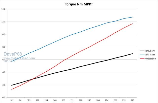

Very good question as I hadn't bothered graphing that data even though I was able to closely calculate what it is.
I don't have any manufacturing data from Fisher & Paykel but was able to work out most of input modes to the motor by watch the PWM wave forms etc.
Also run up the motor on its own over same RPM range logged input power data vs RPM. Then connected the test stator acting as the alternator with no load on it and ran same test. That way was able to calculate closer to what is going on in the complete drive system.

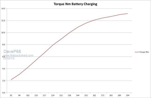

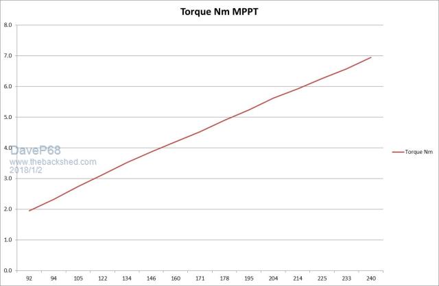

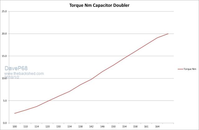

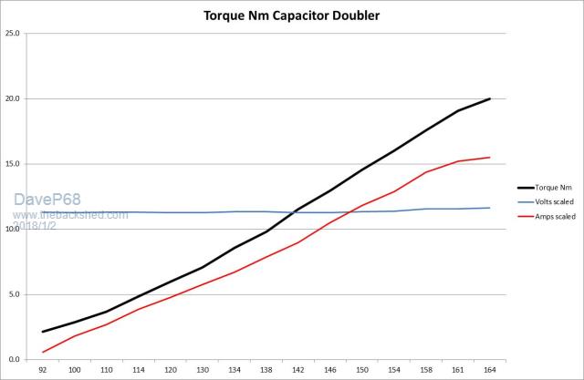

Here are 3 graphs of Torque in Nm over the test RPM ranges as seen in this topic.
First is for simulated MPPT.
Second is for simulated Battery Charging.
Third is for simulated Battery Charging via a Capacitor Doubler.
Note how the Torque curve for a stator feeding into Capacitor Doubler is similar to the curve in the MPPT graph. If one thinks that Capacitor Doublers can replace an electronic MPPT system my new data says that is definitely not the case.
Look up the "Dunning Kruger effect" to check out why I'm saying it this way.
Capacitor Doublers perform even more poorly than directly charging batters on F&P stators from my new data. To achieve better power transfer efficiency in the 3 - 8 m/s wind speed range, just rewire the stator to suit the best TSR. The older 42 pole stators are not as suitable for this with a more limited rewiring combinations compared to the 36 pole copper stator with black rotor caps. Also 36 pole stator are factory decogged!
I can now see why there was lots of effort 9-10 years ago put into capacitor doublers on F&P stators, as the 36 pole copper stators were not common back then.
This is not a criticism to all those who did probably hundreds of hours testing and have also ended up using them on F&P Wind Turbines. Capacitor doublers do work ok with MPPT systems with a smaller loss.
With 36 pole copper stator more common, they can be wired into more combinations to match the stator to the battery voltage for charging while staying close to the best TSR. But there will be much higher losses than a Electronic MPPT system.
One advantage relating to capacitor doublers that is that tends to keep the blades under control in high winds by taking lots more torque at high RPM as per my graph above. A stator directly connected to a battery will tend to go into iron core saturation and has the potential to result in blade run away if the furling system doesn't do it's job properly at this point. So it's not all doom and gloom for capacitor doublers used with F&P stators.

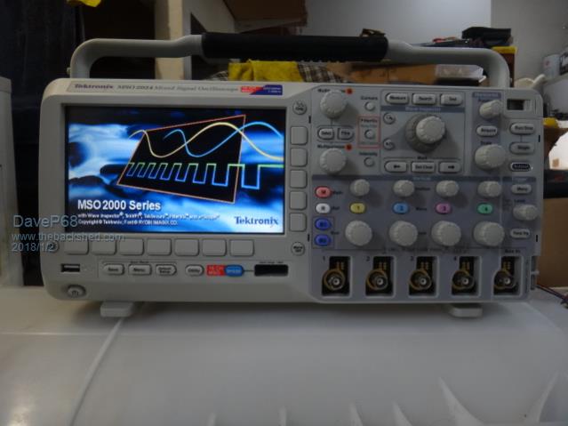

A photo of my latest purchase towards this new project, a Tektronics MSO 2024.
Won't say how much this secondhand unit cost me, was <10% of the current model.

Dave is there any more of those CRO's where that one came from?
DaveP68

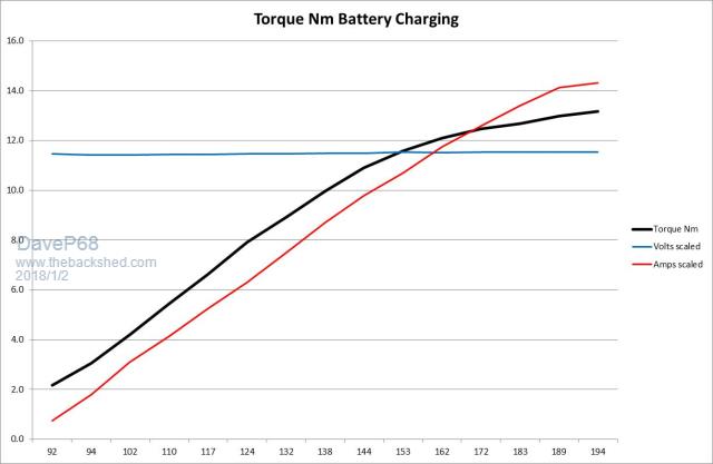

Posted: 06:52am 02 Jan 2018
Hi ks
Happy New year to you and the family at your end.
Had a good read through OP topic you jsu made reference to, a big read bit very informative. I't is a bit lite on the efficiency aspect though which I've covered off in far more detail in this topic.
  kitestrings said
Regarding fillm's comments, I questioned that one too. Looking at it a second time however, I think his point was different, which is that much of the gains of the GTI are found at higher rpms. And, all things otherwise equal, looking at accumulated energy may be closer (presumably due to more run-hours at lower wind speeds). His data logging reference, I believe, was suggesting a comparison of the one variable, in similar fashion perhaps to the side-by-side we saw with -without GOE222 blades. I could be wrong.
A few questions:
What are the purported benefits of the Battery Cap Dblr? The efficiencies are surprisingly lower in your chart.
Why is MPPT only pared with GTI? To me it is the most compelling new (in the last ~4 years) development for battery charging applications.
The big bit seems to be over looked on this topic is energy transfer efficiency. MPPT which ever way it is used is the best system to make the most efficient use of energy generated by the Wind Turbine blades on the shaft.
Don't get confused by fillm's comments re GTI being the only form of MPPT available. A type of Buck down converter with a wide input voltage range with a fixed voltage output for battery charging are available on the market for a price.
From what I understand fillm has never set up 2x F&P Dual wind turbines both using same GOE222 blade size side-by-side. First one using some form of MPPT and the other direct charging batteries with or without a capacitor doubler. Only then after lots of detailed data logging will the results show what's just proven to be the case with my custom built F&P dynamometer.
I don't need a wind turbine to prove my point here as PMA set up in my view is just as critical as all the hard work that goes into mounting blades, balancing them etc etc. That is a bold statement to make, but my point here is a MPPT system set up correctly does most of the hard work for you. Just connect up the 3 phases from a suitable PMA and stand back and watch it pumping out the power day after day just more efficiently.
One other consideration with charging batteries is they are not 100 % efficient in the charge discharge cycle. Lithium-ion can be as high as 95 % but Lead Acid is 80 % efficient at best.
Here are 3 the same graphs showing the input torque of 3 different F&P stator set ups, but this time with "Scaled" Volts & Amps. Results speak for themselves!!
First simulated MPPT.
Second simulated Battery Charging.
Third simulated Battery Charging via a Capacitor Doubler.
Note how the current from the stator runs in proportion to the Torque in the second and third graphs!!
So we can now say with MPPT the equation of 2+2=4, but with battery charging or even worse a capacitor doubler 1 being voltage + 2 being current does not = 4...
Hope this clarifies your questions ks and also allows others following this topic to gain a deeper understanding of how to make better use of F&P stators on wind turbines.

Sorry to say Madness it was a one off sale, very pleased with it as bandwidth is up to 200 MHz at 1 G/s. It's also in very good condition.

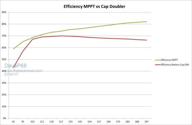

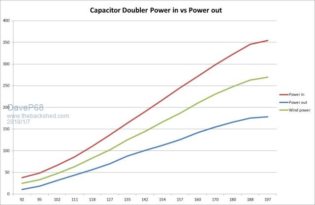

Found an error in the Capacitor doubler used to provided the test results above. Was using too high capacitor value in the test unit. This was due it being used in the past for testing of a 2 to 1 input voltage range MPPT GTI inverter which doesn't behave like a battery at all...
The capacitor value was 280 uF AC way too high! Changed them over to 120 uF AC, but found they were still a little too high. Still gave good results though so left them in for the test anyway. The capacitors actually need to be about 80 - 100 uF AC to get the best results.
Used a 80s stator wired Delta into a simulated battery set at 57 VDC. It ended up working well compared to my MPPT system and a lot better than what can be seen above. My guess is the best efficiency of a capacitor double will be 70 to 72 % at best in it's sweet spot for where most power is produced.
Capacitor Doublers efficiency is around 15 % less than a good MPPT system, so you can't get something for nothing!!
Here are my updated graphs showing the change in power input vs power output and efficiency compared to MPPT.
Note in colour "Green" I've included the equivalent "wind shaft power" that would be driving a 0.8 mm stator on an actual wind turbine.
Hope this is of interest to those following this topic.
Can now calculate all the capacitor values for Capacitor Doublers for any F&P stator wiring configuration, for both star and delta that will be used with a 24 or 48 VDC battery system. This includes all different versions of F&P stators 42 pole 100s, 80s, 60s and 36 pole copper with black rotor caps.
Have the confidence to do this now, as able test any configuration on my VFD test rig and plot the results up to 250 RPM with a high level accuracy.
PS top graph has been edited with the equivalent "wind shaft power" included.Edited by DaveP68 2018-01-08
