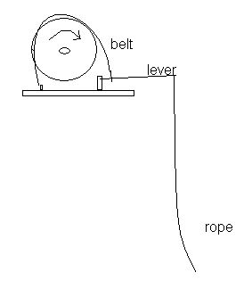

I plan to have a short switch for an electrical brake. However, if the blades are two big for the generator I will need a mechanical brake. What have people done here? Would a bicycle brake work which I could pull with a rope? Any better suggestions?

Trailer brakes are what you have on your caravan, boat trailer or whatever. There are various kinds mostly using a steel disc with some device to grip it actuated by hydraulic, electric or cable. Similar things are used for the 'hand brake' or emergency brake on cars where they are usually cable operated. I assume a cable mechanism would be best for a windmill.
If I understand correctly a F&P once over-reving stops producting significant power (due to flux saturtion?) so the shorted circuit brake will under extreme conditions stop working.
A simple pulley brake is not hard to make, this is a simple 'V' belt pulley on the shaft and a length of matching belt. One end of the belt is attached to the frame and the belt is draped over the pulley with some lever attachment to tension the other end. In normal operation the lever is up so that the belt just lies loosely in the pulley groove but pulling down the lever tensions the belt and the action of the turning pulley pulls it even harder into the groove.

Your method with the belt and lever seems simple enough. If high winds were coming I could lock it down. What material should I use for the belt? Leather? Synthetic? Metal strip?Edited by imsmooth 2008-05-08

Imsmooth, I think the best thing to use would be a 'V' section pulley and of course the belt to match it. The bigger diameter pulley the more effective the brake will be.
I dont think synthetic would work as most materials would melt and weaken at the worst possible moment, leather would be OK on a smooth metal or wooden pulley and steel strip would be good for really heavy duty but you would need a lot of tension to make it work.
