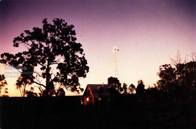

Posted: 07:20am 30 Mar 2018

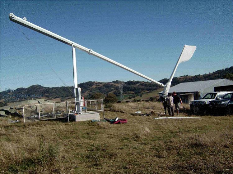

picture of tower
hope this works
OK, so the pic works, now , that is a pic of the old LIGHT F&P wind gennie,so the tower is able to be erected ok with that light load .
Now I have a heavy 'er windgennie and it's heavier, so this is where the problem is .
Not the lifting , but the bending of the steel..
I'll grab some pic's of the pulley block set-up later.
BruceEdited by brucedownunder2 2018-03-31

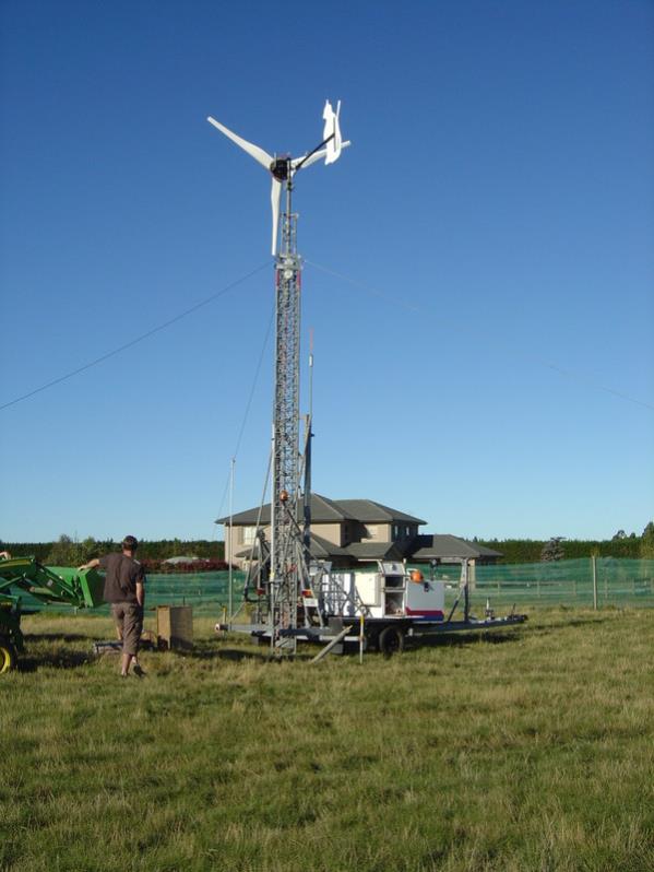

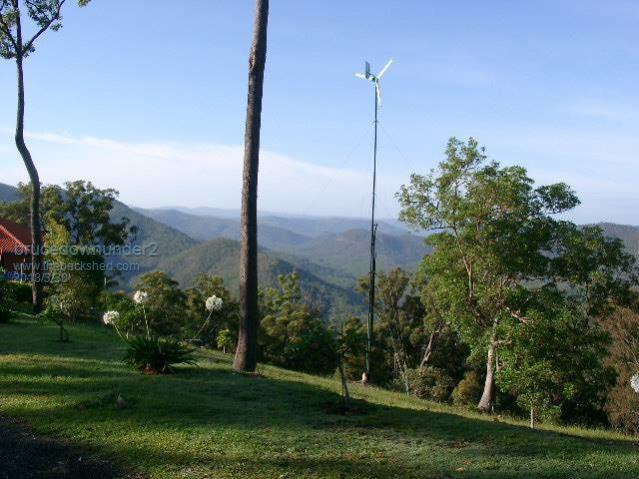

brucedownunder2
Joined: 14/09/2005
Posts: 1548
Posted: 06:46am 31 Mar 2018
OK found a pic of the bending ,I'm talking about ,and you can see the attachment fixings on the tower steel -I've tried moving these fixings to other places ,but still get bending.
by the way,these attached wire cables are actually one only ,going back to a sheave block . It is then pulled up tight by the winch cable.that may be where my problem is?
Bruce
the topmost cable takes all the lifting weight, the lower ones are there to just stop things flopping around and hold the weight of the mast. if you are pulling on the lower cable the mast will bend.
I think you have two options,
use a gin pole
or
build a stiffer mast.
Three options for a stiffer mast, large diameter thinwalled tube, lattice mast, or add outrigger stays to the centre section of the existing mast.
Posted: 08:01pm 01 Apr 2018
The crazy yacht guys have fairly similar problems raising the mast on a boat, and there are quite a few discussions and pictures on the internet about using shear legs to step a boat mast.
However, your mast is a lot longer, and a lot heavier, especially with the wind machine mounted at the top.
If I had to do this all by myself, I would also worry about getting it down again at some future date. As I am now almost seventy years old myself, I can really appreciate your situation.
I think I might investigate getting a driller to bore a sixty foot deep hole and fit a a steel liner. Then lower each section down the hole and bolt the next section on top of the first, and so on. Then finally fitting the wind machine on top (at ground level).
Then winch the whole thing up vertically slowly letting out the guy wires as it goes up. It could be lowered fairly quickly the same way for maintenance. If the whole thing is built vertical to start with, the bending problem is avoided altogether.

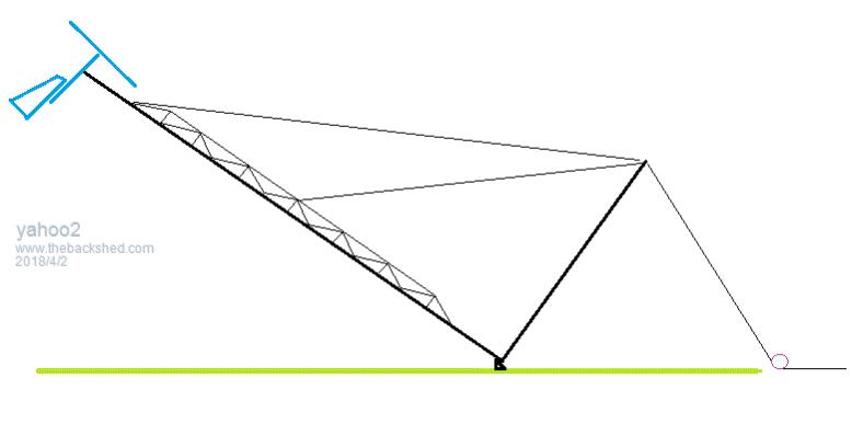

yahoo2
Joined: 05/04/2011
Posts: 1166
Posted: 12:01am 02 Apr 2018
Yep Bruce,
the problem with building stuff with metal is there is only strength in compression and tension, any metal that is on the central axis contributes nothing to stability in the other plane.
That is why the stiff metal masts have a larger diameter and hollow centre (or triangular lattice), when they bend there is compression on one side and tension on the other.
I guess it is time for one of my matchstick man drawings again, the ones the search engines love so much.
Ignore the zig-zag cross bracing, it does very little structurally under tension, as long as there is a triangle at both ends and the outrigger braces are there it will be all good. It would be even better with two outriggers 90 degrees apart tied in a triangle at the outrigger points.
You can also see that the lift angles on the cables stay the same using a gin pole, it stops us pulling on the middle of the tower.
Anyway, something for you to ponder and mull over, I have "dropped" a few towers over 100ft without the correct gear, that last 20-30 feet is pretty scary, it usually ends with something damaged.
edit: Wow it looks much better on the interwebs! its no fusion360 but you get the idea.
Edited by yahoo2 2018-04-03
brucedownunder2
Joined: 14/09/2005
Posts: 1548
Posted: 12:31am 02 Apr 2018
Yes, the Jin pole method is certainly the preferred way to lift and lower.
In my case , I erected a strong guyed vertical pole which I will call the stationary gin pole ,it's guyed and permanent.
this then has pulley sheave blocks at the top and a couple metres down from the top.
My lifting wire ropes go through these permanent stationary blocks and are then terminated on the tower to be lifted.
So, in ordinary cases the gin pole moves from the ground up or from the vertical position to the ground.
in my case nothing moves ,just the tower.
I think less weight (the windgenerator+blades)would solve the problem ,
solution ,get rid of the lot and go solar.
Bruce
Bushboy
fillm
Joined: 10/02/2007
Posts: 730
Posted: 10:30am 03 Apr 2018

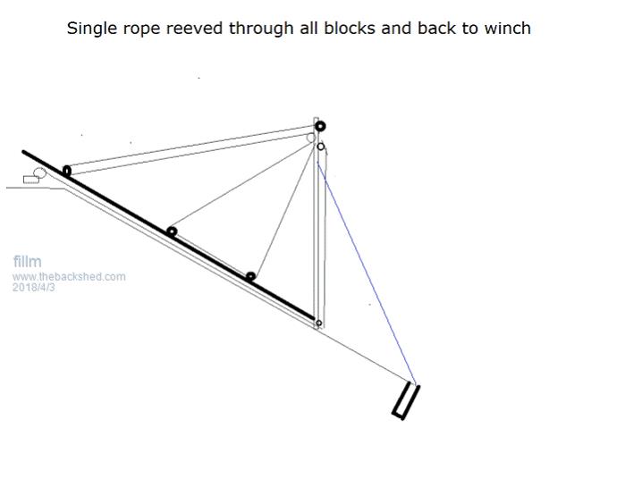

Bruce,
Yahoo is correct an the method he has shown is the simplest and most cost effective way of raising turbine towers.
As I know a little about your tower from visits many years ago, and from that and the pictures I can fairly well say that its not capable of a 80kg turbine without major modification . The lighter F&P were no problem in the day but now you have trippled the weight and extended the tower top with the 89mm ID Pipe . It is made from 75mm x 6 x 3mtr angle as you gave me a few pieces back then, I can not remember the full details of your build method but the best config is as a 20mm overlap stitch welded to give a + formation which give stability but still not as good as 100mm to 125mm pipe.
Your lifting method is pulling on different radius points and if they are all 3 apear to be going back to the same winch drum. This will not work as different lengths will end up with the inner point getting ahead and the upper lagging a bending the tower as it appears now .
The lifting method needs to be changed to the conventional "Gin Pole " this then has the frt guys permanently attached and as shown in Yahoo's drawing is pulled from one point and the weight of the pole assists the lift to the point of over counter balance at the top .. Or you could reeve as a single wire through wire rope pulleys and it would then pull evenly but the weight still might cause tower
bending if the structure is flimsy with the 2kw on the end .
Also from your pictures you have raised the height of the tower with some 89mm pipe that looks to be just bolted in the first 1 - 2 mtr painted white and not moved the upper guy rope . This is most likelly also causing the upward bend in the under the guy point .
The Upper guy point needs to be as close to the top as possible to minimize the unsupported, if you change this and also run the 3" 89mm pipe past the upper guy point it will then support the leverage exerted onto the upper section between the intermediate and upper guy point.

the Tower, thanks for the illistrated drawing , my set up ie very similar,except for the addition of one extras sheeve block .
This illistration works , but the friction in the intermediate placed sheeve blocks causes some difference in lifting forces. ( thats my guess ,anyhow)
I don,t have any problem with the winch ,it's heaps strong enough . The weight of the 2Kw Gennie is a factor ,indeed.
If I could just get the bending sorted out to some lesser degree,I think all would be OK , I reckon once it's up around 45 or more degrees it would behave itself ,up and down.. Ilda and I ,sometimes just myself , have raised and lowered this contraption many uneventfull times in the past -I carry a deadman up-down-stop control switch on a 60 metre lead around the paddock as we ,I, check all safety aspects while in operation . works perfectly .

SparWeb
Joined: 17/04/2008
Posts: 196
Posted: 04:36am 06 Apr 2018
How close to the swing of the blades is this top guy wire attached?
The photo you posted the other day makes it seem like there's at least a meter between the tip of the blade and the highest guy. Moving that up would make a big difference.
The change in paint colour from white to green makes me think there's a joint there, too. If so that will contribute to the bending. Getting the guy wire attachment above all of the tube joints will also reduce the bending.
The look of it though... it's still a heavy turbine for 100mm square tube. I'm not comfortable looking at that, like you are.
I am also no fan of Exmorks, especially the 2KW model. I saw the aftermath of one that blew up - in a wind speed it should have survived.
Steven T. Fahey
