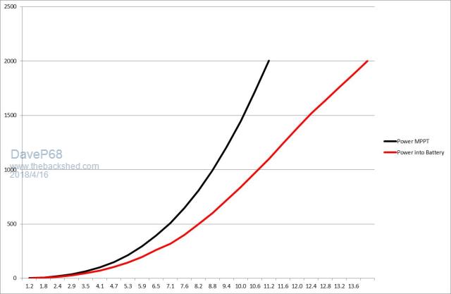

Would like to challenge the "myth" that there isn't much difference between MPPT and directly charging batteries in terms of the accumulated power each system produces.
From careful analysis of factors like number of blades, blade TSR, shaft torque produced by blades and torque required to drive the PMA to provide a given output power. I have concluded there is a "minimum of 35% less accumulated power produced" when directly charging a battery in wind speed range 3 - 8 m/s vs MPPT.

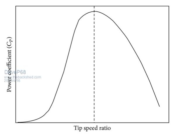

The torque produced by blades increases at a rate of 4x as the wind speed doubles. This will remain relatively constant if the blades are kept in their optimum TSR power coefficient (Cp). Tip Speed Ratio is directly related to Torque, please refer to the graph below.
If a PMA isn't correctly matched to blades with respect to the torque required to drive it, then energy will be lost. The current produced increases on a PMA at a rate of 6-8x as the RPM doubles if the voltage is clamped (by battery voltage). Torque is proportional to current drawn from a PMA. If torque is proportional to current the blades end up operating outside their optimum TSR with a 6-8x torque increase for a doubling of RPM.
The big advantage of using MPPT is no matter what the blade TSR is, the torque taken by the PMA will be kept within the range of 4x increase as the RPM doubles. To put it simply MPPT allows PMA output voltage to increase over the operating RPM range to keep the current in proportion to required torque taken.
Here is a graph of difference in performance between MPPT and Battery Charging.
The bottom scale m/s of wind vs power in watts.
As you can clearly see the MPPT black line on the graph produces FAR more power at lower wind speeds resulting in more accumulated power produced. Edited by DaveP68 2018-04-17
