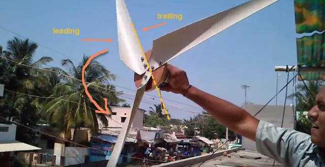

Hi All,
So I have some questions.
In so many videos I am seeing on the net, PCV blades are cut with the leading edge being closest to the wind and away from the hub (they are mounted on the trailing edge being in line with the axis...), which seems opposite to drawings, and also how the GOE222 blades are mounted.
So I am confused.
Why is it that PCV blades seem to be mounted the opposite way to aerofoils?
Is it because that is the only way they can really be mounted?
This one for example, turns anticlockwise (ignore that fact), the leading edge is towards the wind, and the trailing edge is mounted onto the hub and in line with the axis.
https://www.youtube.com/watch?v=6ZTVeFh7-0Q
Compared to say the GOE222 blades which get mounts so the leading edge is also towards the wind, but the leading edge is in line with the axis, and the trailing edge is behind the mounting point on the hub.
Not wanting to get technical too much here as I am not schooled up in blades etc to a high level. Dad was over this afternoon and we were discussing the blades, as I started cutting my PCV blades out, and it just struck us as being 'interesting'.
We can only assume its due to the fact that PVC pipe blades need to be mounted and the only real way to do that is by mounting them on their trailing edge... Edited by BarkyJ 2018-06-10

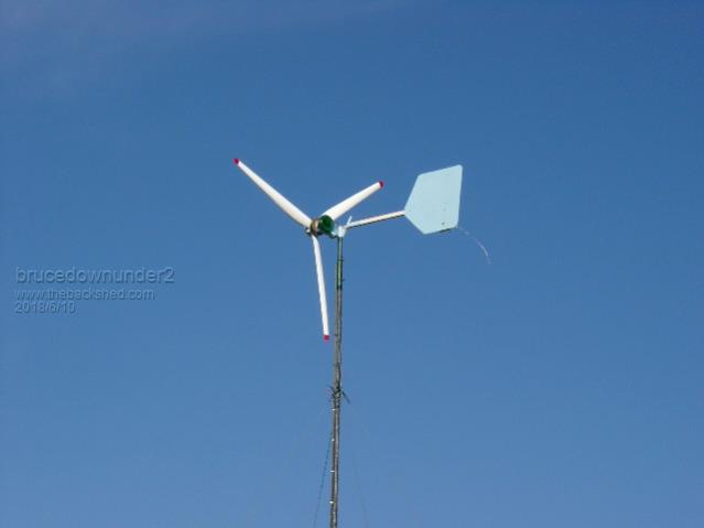

Posted: 11:44pm 09 Jun 2018
This is an old pic of my plastic blades . They were good ,I suppose I could say that ,not excellant ,but bloody strong as a battleship . made of 300mm chemical resistant plastic pipe -some fancy upvc or something that dosen,t break easily ???.
I think it was 12mm or maybe 16mm thick grey stuff .
Anyhow , they are fairly hard to carve ,have to use very sharp grinding tool discs and leather gloves ..
storm hit mine and one hit the tower ,smashing a piece off the tip ,she got out of balance then and broke off at the hub ,.
yours look as if they are carved the wrong way ,hard to tell from photgraphs.
mine were big buggers,a bit noisy,but turned the F&P very easy. the main bitch with F&P thick wire stators is the groaning noise they make getting up to speed and coming down from speed,,forever annoying for your neighbours.. thats a dual up there.

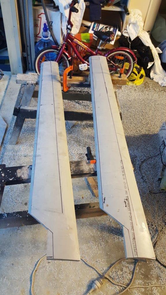

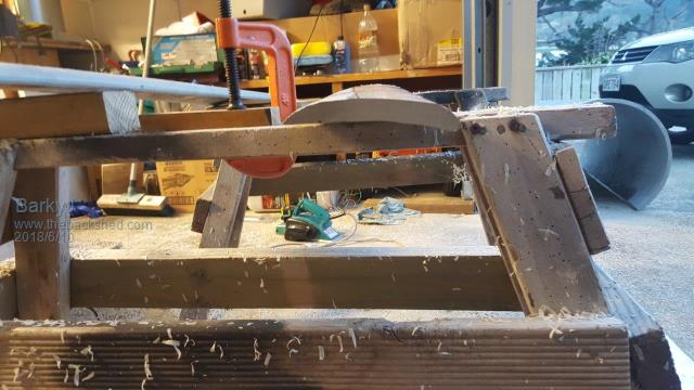

BarkyJ
Joined: 26/04/2018
Posts: 114
Posted: 12:00pm 10 Jun 2018
Very rough cuts at the moment.
Cut 3 blades out, but only started dressing 2 of them so far.
If you look at Glenn's build (http://www.thebackshed.com/Windmill/articles/GlennL.asp), his are also mounted the same way as described above, where they are bolted to the hub with the trailing edge, as opposed to the leading edge. Which is giving me the impression this is really the only way you can mount them.
So I would love to see photos of pipe blades being mounted.
brucedownunder2
Joined: 14/09/2005
Posts: 1548
Posted: 09:18pm 10 Jun 2018
Barkley, yes, your blades will fit the bill ,just fine .
I cut mine sort of across the length of the pipe , hard to describe. sort of not straight along the pipe,but a little bit angled (length wise). your profile is just like mine , it should start early and in light breeze.
Beware ,the rotor will hum a bit ,depending on the rpm ,sort of disappears the faster it goes.
I'll search for any pic,s of my carving ,but I can,t remember taking any?.
Bruce

BarkyJ
Joined: 26/04/2018
Posts: 114
Posted: 09:57pm 10 Jun 2018
Thanks Bruce
Yeah mine are not straight down the pipe either. It ended up being that the leading edge is somewhat straight down the pipe, but the trailing edge is at about a 3 degree angle, as that is what was intended to be mounted on as per all the other PVC builds I have seen. So this gives a little bit of twist.
Now I just need to shape them a bit more, and sort out the tips, and figure out the mounting.
If you don't have any pics of the carving, if you do at least have one of how they are mounted, that would be a big help.
Are yours mounted on the trailing edge like the other PVC builds, or are yours somehow mounted on the leading edge?
