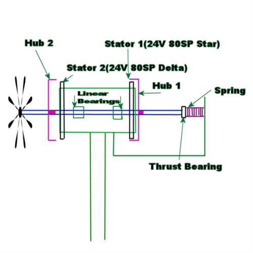

I'm contemplating a Dual stator windmill that runs as a single stator at any one time. One stator for low winds, the other for high winds.
I have had a good look at the dual stator designs that others have come up with and they do look appealing but I was just wondering about the pros and cons of a slightly different approach.
This design would have the two stators mounted as normal for a two stator design. The hubs also are attached to the shaft as usual, except the top of the hubs are back to back. Instead of using rotary bearings, I was thinking of linear bearings, so that the whole shaft can move freely along it's axis.
the Hubs are set on the shaft so that initially only one hub covers it's stator. If the turbine blades are pushed in 3cm, the hub slides off the first stator and the second hub slides onto the second stator.
And here's the tricky bit. At the rear of the shaft on the opposite end to the blades, is a spring which keeps the shaft "forward" until the wind reaches a point of 600RPM. at this point the spring starts to compress and so Hub1 starts to disengage it's stator and Hub2 starts to engage it's stator.
By 700RPM the spring is fully compressed and now Stator2 is fully covered with it's Hub and Hub1 is fully disengaged. During this period of transition, both stators are providing a proportion of the power.
Ok, so why do all this.
Well, firstly it makes a windmill which runs on the correct stator at the low speed range and then the correct stator for a high speed range.
Secondly, if the windmill is running in the low range then the blades aren't wasting energy driving an innefficient generator which is designed for a high speed. And the same applies when it's running in the high range. All the energy of the blades is powering only a stator built for the speed range it's in.
I realise that the blades also will be designed for a certain speed range, but at least it can produce a useful increase in power output when it's running outside the designed speed range of the blades.

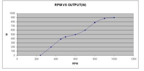

Here's a graph of what the output might look like with Stator1 setup as 24V 80SP Star and Stator2 set up as 24V 80SP Delta
My Thanks to Michael at EcoInnovation for kindly letting me use his data to create the above graph

For those who hate working things out from descriptions, here's a diagram.
Actually, when I did the drawing, I realised the hub bottoms would be facing each other, not their tops as I described earlier.

Posted: 10:36am 26 May 2008
Dazz,
I like your thinking. Very innovative.
Though I see it's output as to be compared against a single rotor design rather than a twin.
It's min and max is still the output of one rotor though when set up right the combined power outputs will follow the wind power rather than it's velocity curve I feel. Great!
Would not the combined outputs of 2 individual fixed rotor wind gens, if wired the same, be more though?

Posted: 03:38pm 26 May 2008
I agree with Gill in that you will get more output if you just leave the two stators connected. PowerOne makes an inverter that I have an I on that allows you to select the amount of wattage you want to draw for a specific voltage or rpm. This way you can put a low load at low rpms and increase the load as the rotor spins faster. I think that when you start getting into more complicated mechanical designs the risk of failure increases.

Dazz, did I miss it? I mean the obvious plus point that your scheme has the cogging of only one F@P at start up? I think your scheme has a lot of potential if you have a lot of light wind days.
I do wonder though if you would be able to get a smooth transition between the two. Wont the low speed rotor tend to 'hold on' to its position until finally lets go and the high speed rotor get to grab it's stator and pull it in?Edited by KiwiJohn 2008-05-28

The transition I'm not really sure about. you could well be right there. Annother associated issue is that the force of the wind must be able to push the first hub off it's stator. Is this force big enough?
I do know from my SMFIS work that when lowering the hub onto the stator there is no force pulling it in and then suddenly a lot of force pulling in, which seems to stay roughly the same for the rest of the lowering.
I'm hoping to find a point where the forces on the hubs are roughly even but opposite, but who knows. Maybe the wind force is strong enough that it doesn't matter. If there is a quick transition at the end as you suggest then perhaps a shock absorber of some kind will be needed too.
Selecting the spring is going to be difficult. If I want the changeover to be at 300RPM then i'll need to measure the axial force at that speed, or at least find the relationship between the speed and that force

Gordon, I looked at the wrong numbers on my note pad. The resistance of one phase in Star is 0.4ohm and I reconnected into Delta and measured and it was 0.1ohm
Obviously with such low values allowance must be made for considerable error
Daryl
GWatPE
Joined: 01/09/2006
Posts: 2127
Posted: 12:13am 29 May 2008
Hi dazz,
the computer lab must be providing wrong numbers as well. Increasing the wind velocity from 10m/s to 22m/s increases the power by a factor of 10.5, not 8.8. Gordon.
become more energy aware

dazz,
How about a set of weighted balls to move the second hub over the stator, so you have a 2 stator unit at the mean wind range, and another set of balls to pull the first hub off the stator at high wind speeds.
Also thought that moveing the hubs would be easier and cheaper, so you could secure the prop and shaft, owing to the high latteral forces that you would have when it furls at 1000 rpm ( mine keeps chewing out the rear bearing housing)

Hi grolly,
I imagine the balls system would have trouble coping with yaw, especially during furling
Daryl
