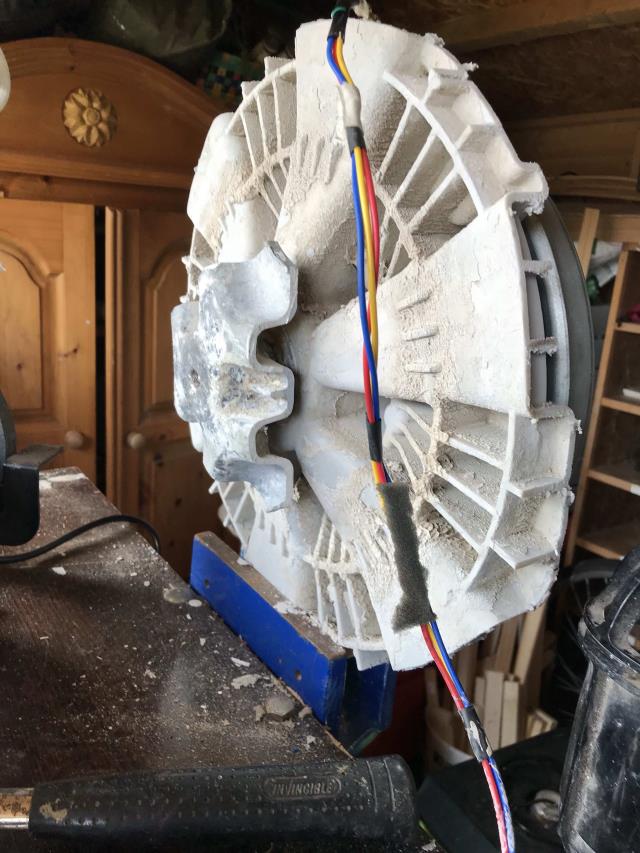

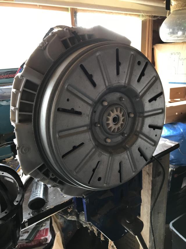

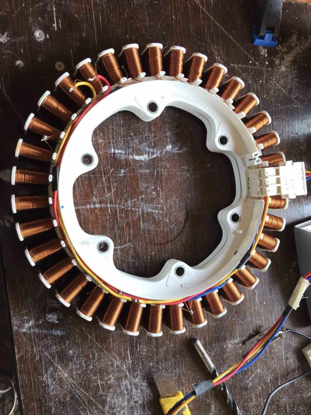

Firstly apologies for my limited electrical knowledge but I am hoping someone on here might be able to tell me where I am going wrong.
I have taken a Fisher Paykel motor out of a washing machine. It is a 36 pole version. I have rewired it to 3 x 4C as per the great diagrams on this site. I have cut back the parts of the washing machine housing and am still using the original hub from the washing machine.
I have wired it up to a 3 phase rectifier and then is wired to a light bulb. Hand turning produces nothing. I attached it to an ammeter which produced a large amount of resistance in terms of finding it hard to hand turn it.
I have attached a couple of photos to show you how far I've got. Any advice is greatly appreciated.
Seb the novice.
Posted: 10:21pm 01 Apr 2019
Finding it hard to turn with the amp meter connected is normal, a good sign. Was it also difficult to turn with the light bulb? It should be, but not as hard as the amp meter.
Can you test the output volts while turning by hand?
Also thats not a F&P, its a LG. Works the same.

Posted: 01:41am 02 Apr 2019
You will probably need a multimeter
it won't cause much resistance and you'll be able to see how much voltage it is putting out at what RPM
when these motors are shorted out they are very very hard to turn

Posted: 09:05pm 06 Apr 2019
Thank you to both of you for your replies.
I hooked it all up to a multimeter and handturning it, it produced upto 20V.
I tried it with an old bike light made up of 5 LEDs which lit up, flickered and then went out (I'm guessing I fried them).
So, I'm really pleased that it works but now want to work out how to regulate the voltage output. This is a project for the children in my school so I want to show them something that is stable and can produce approx. 12V.
Any suggestions on how to regulate/control the voltage output would be greatly appreciated.

some late info.   if you want a good pma, just  BUY ONE.  on ebay/amazon.   look for permanent magnet alternator, and KNOW  what specs you want.     re-purposing an f&p motor is LESS simple, than one might think.   the motors are  MULTI-pole, 3-phase, bldc, outrunners.     in a 36 pole stator, there are  TWELVE coils per phase.
in a pma, there should ONLY be  three coils per phase.    changing the config of a stator, DOES NOT CHANGE THE CONFIG of the stock rotor.   some people have come to believe that it is a good idea to Interconnect  ADJACENT coils.   IT  IS   NOT.
