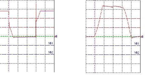

I have helped Dennis with some recording of CRO outputs of an 80SP in star configuration at 350rpm.
I have arranged the pics as comparisons. 200uF was placed between each set of windings. readings were taken unloaded and supplying a 24V battery at a constant voltage. All vertical scales are 10V/div.
this pic is the unloaded output waveform without and then with capacitors before the rectifier from the star point as reference.

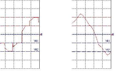

this pic is the loaded output waveform without and with capacitors before the rectifier from the star point as a reference.

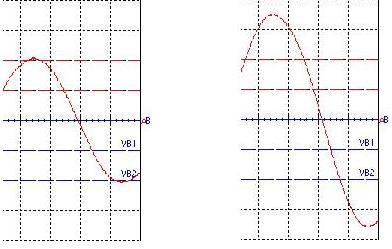

this pic is the loaded output that the battery sees. This is between bat -ve and the winding. this is across the bridge rectifier.
The results show clearly the voltage gain. The loaded current at 350rpm increased from 3A to 11A with capacitors.
The capacitors do significantly reduce the cutin speed. This will allow a particular windmill with a high cutin to produce current at approx 2/3 the rpm.

Nice to see some clarification of what happens. The best feature of this it to allow larger blades to take advantage of lower winds.
I guess that changing the capacitors values will allow fine tuning to get out of stall much like a resistor does,... but without the loss. This perhaps should attract more positive attention than has been attributed thus far.
It may allow others to avoid the gearing thing,if the prop size allows for a 2/3 compromise to achieve close to the same thing.
The non-linear response of the diode has been cleaned up quite a bit, this may help those who wish to track rpm via frequency. Usually diodes under load make so much hash, that filtering is very important/tricky. The input line looks clean enough to read with a normal digital volt meter. (freq range)... handy. Usually, once cut in is achieved, the meter goes haywire. (no filter).
All in all, thanks to you and Dennis for these results.

Gordon, when you say the current increased from 3A to 11A at what point in the circuit are you measuring this?

Certainly it implies an advance yet "The loaded current at 350rpm increased from 3A to 11A with capacitors" is of no benifit if the power drawn from the motor is 4 times as much at that rpm....
As commented with Brucedownunder's test bed, power OUT has no valid reference for comparison without an accurate power IN comparison.
Without that data I can only say the wave form is pretty, but does pretty charge batteries better? Edited by Gill 2008-07-06

Hi Gill & KiwiJohn,
I think you will realize that I have in the past been critical about the effects of capacitors and windmill loading also.
The currents stated above were battery load currents. This means that at the 350rpm level, a F&P 80SP stator, is only just above cutin to produce the 3A. The capacitors allow the mill to produce a higher voltage and hence at the same 350rpm, more current, 11A, can be produced. I have not mentioned anything re efficiencies. I have merely pointed out that capacitors can be used to better match the windmill output to the load.
In this example, the same stator would cutin at a lower rpm with the capacitors. It is obvious that if this was a real windmill and not a test bench that more power would need to be extracted from the wind and this would result in a slower rpm and hence the current gained may not be as much as the test bed at constant rpm. This purely highlights a way of producing power from a lower rpm, without the need of rewiring. .. Gordon.
