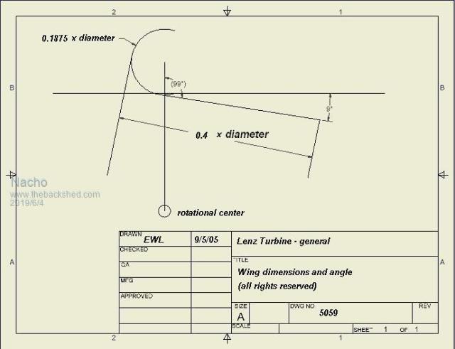

Hello,
I much appreciate if you could help me clarify Ed Lenz wing dimmensions.
According to his published information -see attached picture-
- Wing Width (¿Diameter or Radii?) = Turbine Diameter x 0,1875
- Wing Chord = Turbine Diameter x 0,4

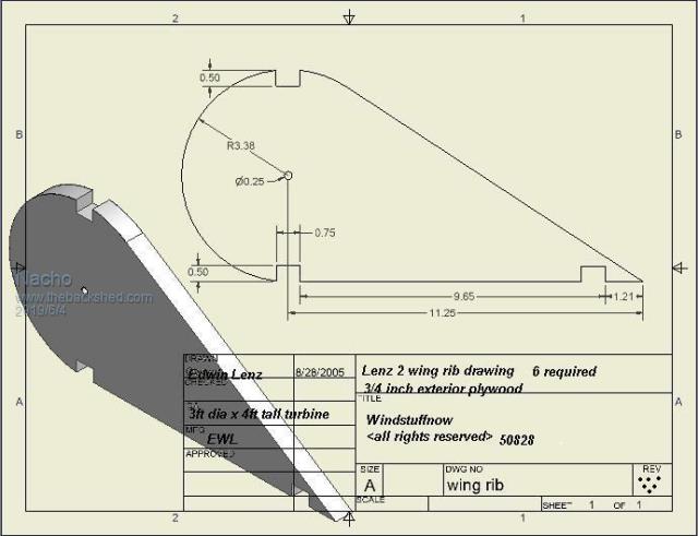

Ed Lenz shows ¿R (Radii)? = 3.38 for a 3 ft Turbine Diameter as an example in the same document. See second image.
If Wing Width = 0,1875 x Turbine Diameter, then
3 ft x 12 inches/ft x 0,1875 = 6,75 inches (3,38 x 2)
which seems diameter nor radii...
Please:
- Are that formulae adimensional? In inches?
- Any formulae in metrics?
- Is the Wing Width the wing diameter or the wing radii?
Thanks,
Edited by Nacho 2019-06-05

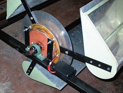

His measurements are in inches
Lenz2 turbine
This picture (from that site) might help you visualise it better
