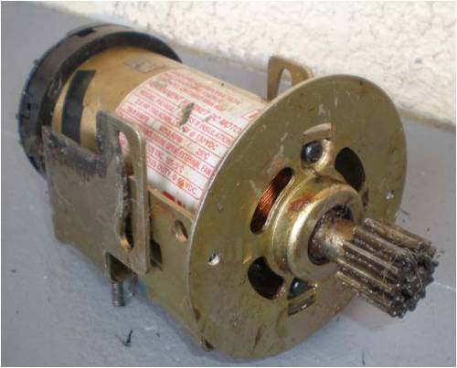

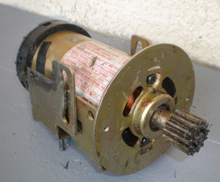

sorry for my late response, the model is the same one as Allan mentioned, only the bracket is different (http://cgi.ebay.com.au/eBayISAPI.dll?ViewItem&item=13024254 6823).
Dodgeman thank for your advises and tips. i had to read your mail twice to understand it.
just to tell you a bit about my experimentation that i did during the week end. i am actually in the process of setting up a wind turbine. i received most of the equipment that i need for the job, like charge controller, batteries, DC to AC inverter, solar panel, DC motor(s.
As mentioned earlier, i have already cut out the blades from an 8" PVC. the blades are each 34" long. all i need to do now is make a tower for the turbine. also i am going to mount the turbine on top of my house. i have already work out the plan for mounting the tower. the main problem is noise vibration which hopefully i am taking care of in my plan.
i made some modifications to the DC motor that i have purchased. The motor is so easy to dismantle and i removed the carbon brushes and turned the shaft by hand. As expected, the rotation was more as compared to before. the brushes was causing the shaft to slow down. therefore i decided to modify the springs that push the brushes and making it softer. that way the pressure applied is less and we have more rotation. after mounting the motor, i tested it and it work just fine. i am sure that even in a small breeze, it is going to turn. the only problem now is that the output voltage with this type of motor will be around 5V. I am thinking of using a stepper to increase the voltage or even using two wind turbine. i guess i will have to wait and do some more tests.

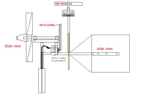

The only suggestion for gearing that I have is a design I drew up some time ago for a fan blade I had gotten for free, which I had intended to make into a large wind generator in the future
It is just a quick paint shop sketch of how I had planned to make it, I was planning on having the prop attached to a drive shaft, which will turn a pulley, which will, in turn , spin the smaller pulley on the generator. in the diagram I was thinking of GM alternator conversions but any dc motor should work.
I have started smaller and began my actual experiments with dc motors and direct drive instead of rewinding alternators yet.
I hope that helps, I am off to bed now, its 11:38 pm here and I work at 5 am, I will check back tomorrow.

thanks for the design. very interesting. will keep you update.
asvin.b

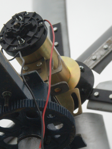

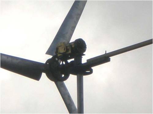

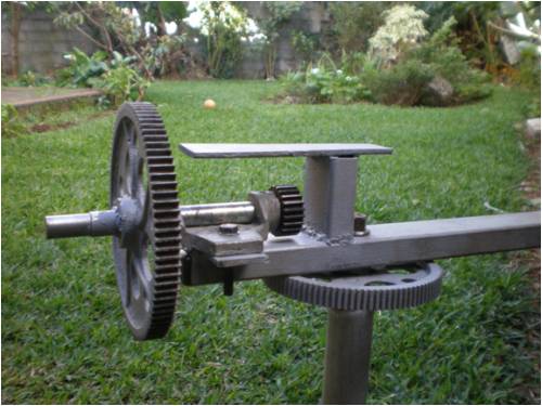

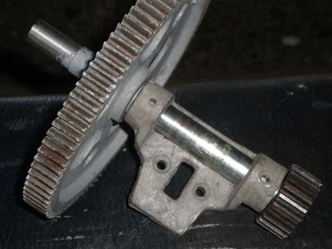

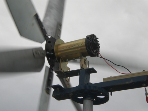

Hello I’m back. Hope you have been well. On my side i have made some progress since my last post. I manage to build my tower on my roof. Please see pictures. The pole is 10 cm inside diameter and is very heavy (6 feet high). It has two 40mm poles as supports with a base in concrete 4 by 3 feet. The concrete base was sealed on polystyrene to absorb the vibration and reduce the noise level.
After a lot of trials and errors, I have been able to design and make a head base for the wind turbine. Base on your advices I have included a gearing system. The blades are made in PVC and are around 3 feet in length.
Yesterday I connected the blades on the tower and it work just fine. It turned like mad. I even got scared at one point. It was noiseless and there was no vibration. I further added metal wires to support the tower as an extra safety measure. I left it over night. I guess this was still the easiest part although it took me a while to gather the entire spare parts and getting them adjusted/ modified.
The biggest challenge was to find a way to connect the 12 DC motor to the head and getting it to work. I spend all my Sunday trying to do that. The engine was fixed on top of the front part. It became very heavy but nevertheless manages to place it on the tower.
The problem is that because of the gearings it became slightly hard to turn by hand and therefore did not turn at all even in strong wind. I made lots of adjustments to make the gearing smooth. When I turned the blades by hand, it does rotate to around 10 times but then eventually stopped dead. I need to find a solution to my problem and I am desperate now.
I still need to take a picture of the turbine with the DC motor attached to it. Please advice.
asvin.b

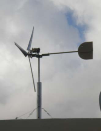

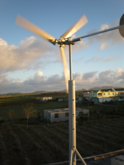

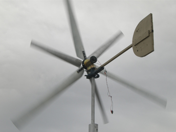

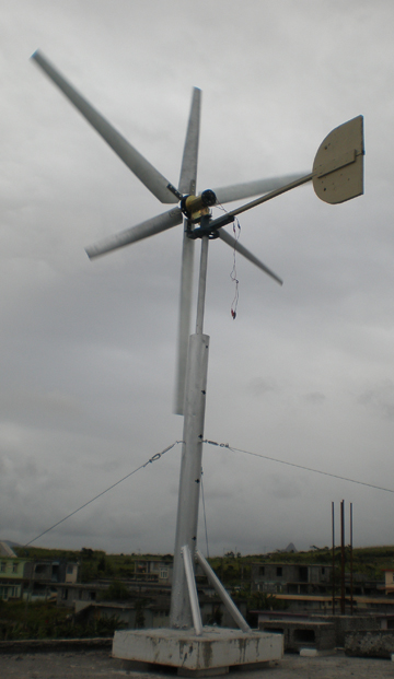

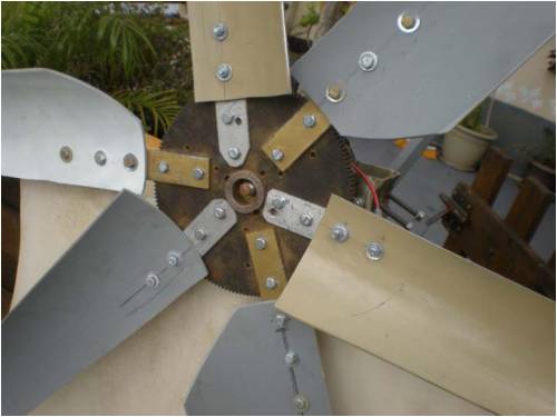

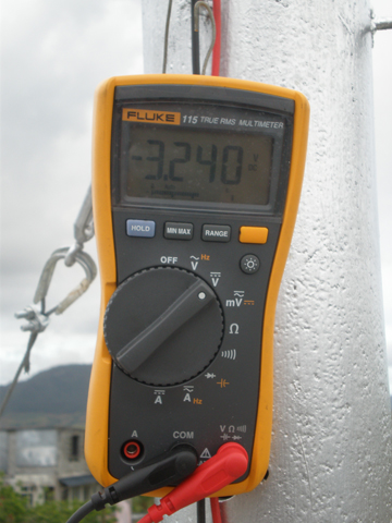

Posted: 05:51am 01 Sep 2008
just posting some more pictures of my wind turbine with the motor. will try to get a close up later on.
cheers
asvin.b

Hello again,

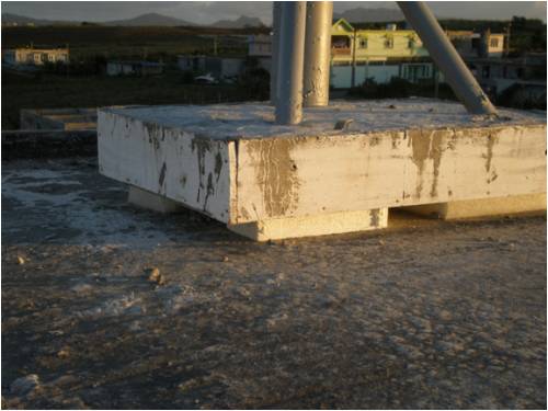

Good to hear from you, and nice to see that you have progressed, Your whole machine looks very stong and capable to me.
I love your tower too, I know my tower needs work to be as sturdy looking as yours
(I have recently regressed rather than progressed, but I will post about that in my other thread
I think your gear design looks great also, I would like to know, What that gear assembley is from ?
From the pictures, I cannot see why it would not spin in the wind.
I do believe that there may also a "magic gear ratio" that must be found in order to compromise between startup capabilities and RPM at a given windspeed.
Unfortunatly, I am afraid that, that "magic ratio" will probably have to be determined by repeated trial and error.
For mine, I was looking at starting with a 2.5:1- {1 drive shaft RPM to 2.5 motor shaft RPM} to begin with, this should put my motor RPM up in the 500-600's in good wind (I really need an anemometer also)
What gear ratio do you figure you have there? I am guessing here,, but I counted what I could see in the top picture and guesstamated about 60-70 +/- teeth on the large drive gear and about 15-20 +/- on the driven gear (<motor gear)
I am assuming this ratio, but, 65/17 gears would give you a ratio of 3.82:1. That would speed your motor up quite a bit, but as the ratio increases from 1:1, it gets proportionally harder to turn, Your description would make sense as to why its very hard to start, especially if your motor has strong "magnetic cogging" also.
If I understand correctly, you said that: "it spins like mad without the motor" ??, with no load on the Prop?
or, do you have the motor loaded as well? With a DC magnet motor, it will become harder to spin, as it encounters electrical resistance from the load.
I wonder, if your wires may have been shorting to ground? causing difficult startup/turning of the motor?
I also wonder, if 3 ft PVC blades are long enough and/or wide enough to to catch enough wind to get it moving with the motor/gear resistance.
Also, is that drive shaft mounting apparatus a ball bearing carrier? or is it a sleeve/ bushing type? It's tough to tell from the pic.
(as I am sure you know>)a bushing would create some added rotational resistance as opposed to a ball bearing setup.
I sincerely hope that I have not advised you wrongly by suggesting the addition of gearing to your mill, I know how much work it all is to put together, I do plan to gear my current motor as well.
From my non-geared experiments, I have been unable to produce the continious voltages I am looking for, with a direct driven 90V/DC motor generator.
Please keep us posted in your progress and keep at it, you have only discovered 1 way that it wont work, 999 more to go and you will have it
DM.
it came from an old textile machinery.
well the gear on the dc motor is around 3.5 to 4 cm in diameter and the one in the picture above is around 15 to 16 cm in diameter.
If I understand correctly, you said that: "it spins like mad without the motor" ??, with no load on the Prop? or, do you have the motor loaded as well?
it spin very well with no load. also i don't think there is any electrical resistance because i did remove the carbon brushes from the engine as i thought it was causing some kind of brake.
It has not ball bearing. it a part that i found and which was used for something similar in a machinery part.
