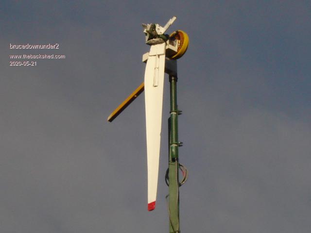

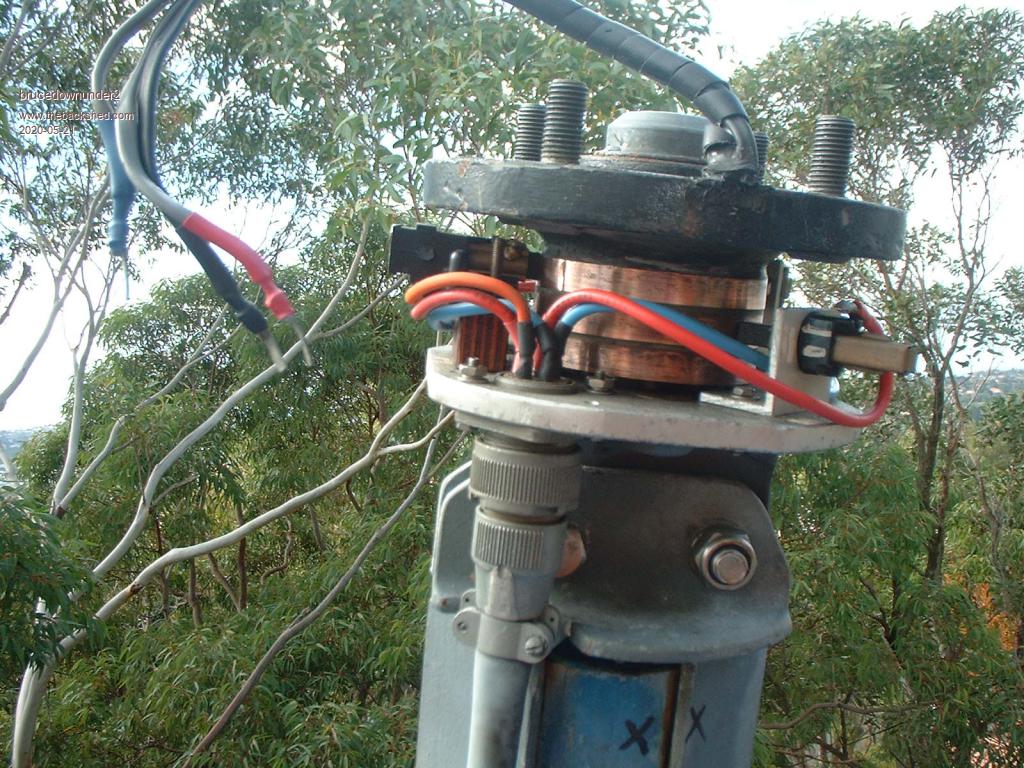

I was browsing through my albums this morning (thanks to self-isolation,lol.)  and came across a couple of hard worked parts that formed my windmill at the time...
Along came a big storm , and all that carving ,way back with Phil M and I came to an end !!.
It was good fun ,the slip-rings were bits and pieces of copper water pipe ,car alternator brushes , and epoxy resin ..
I think this was way back in 2008 -sometime back then ???
 /Users/bruce/Desktop/005.jpg/Users/bruce/Desktop/slip
/U
sers/bruce/Desktop/slip rings.jpgjavascript:openWin('UploadImage.php?AuthorID=15','images','toolbar=0,location=0,status=0,menubar=0,scrollbars=0,resizable=1,width=400,height=220')
Bushboy
Posted: 12:15am 21 May 2020
That is a very fine piece of engineering

The rotating part(hub) was a ford cortina(that should stir the oldies ?).  I used a lot of bits and pieces from wrecking yards,-those were the days when thongs and no shirt were permitted ,today you have to be dressed like a spaceman !!!.
The plastic for the blades was a "ABS" tough plastic ,Phill M has a sharp eye for the right stuff !.  You could hit it with a hammer ,no harm .  But shaping was a hard job , we used "Carbotech" wood carving disc. Very dangerous in the inexperienced hands, so don't go there if you are a beginner.
Messy, plastic shavings everywhere, and they sort of stick ,probably through some sort of electrical build-up in the shaving process.
I noticed that one blade was sort of bent (twisted), and no matter what I did I could not un-twist or get it like the rest.  So, maybe the plastic pipe(was a very big pipe, around 300mm) has some sort of "memory" ??.
I covered the slip-long assembly with an old aluminium saucepan ,kept all the crawlies out of the works Dept.
Bruce
