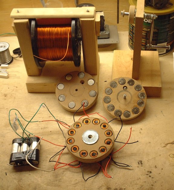

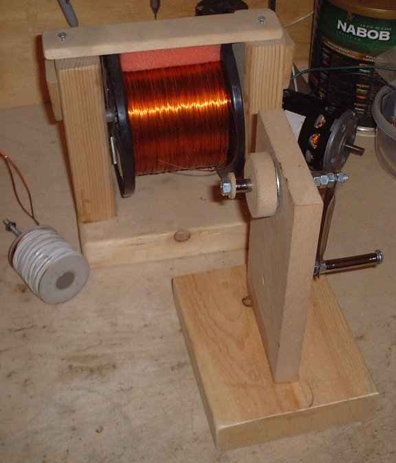

Here you will see an 8 and 12 pole rotor and a 12 coil stator. A large roll of magnet wire 21 gauge, and just in front of the nabob coffee, is my coil winder built with the (HDFB) high density fiber board. The magnets are 11/16 x 1/8" thick neodymium finger pinches. Oh the magnet wire has a sponge glued against the large coil to prevent spooling off - I can adjust the board holding the sponge to create tension.

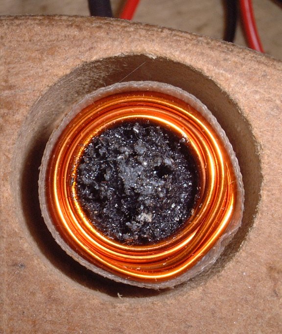

Below is a coil in the 3/4" (HDFB)it is much harder then the mdfb or medium density board. The coils are 50 turns of 21 gauge wire. The coil is about a 1/2" deep and wrapped in transformer tape - the expensive stuff.
When I drilled the hole with a spade bit it left a hole in the center under the coil where I ran the center coil wire through and then I drilled a hole on the edge of the coil slot to feed the second wire the one that comes off the outer section of the coil.

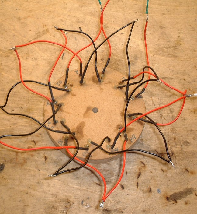

This has been wired and un-wired and re-wired so many times it no longer looks straight and plum - for fear of breaking a coil lead.
I chose the outer wind of the coil to be represented by red I am going to have to learn some real electrical rules. Show me a boiler with controls all over and I understand what is happening inside the pipes but electrical is a different beast.

When I build a gig to do a task, the main thing is that it works but more important if you are hacking away at an idea you need the re-tool ability so you spend less time building stands - make it adaptable and not as small as you can get away with but as big as will work for you.
OK so I have a 12 coil stator with 21 gauge magnate wire
50 windings per-coil and the above mention magnets.
So I have this stator labeled as follows
A 1 + --- A 1 -
B 1 + --- B 1 -
C 1 + --- c 1 -
A 2 + --- A 2 - (...)AND SO ON(ELLIPSIS POINTS). HA HA HA...
With this pattern abc x 4 with (+ - )
Can you suggest some wrings for me to try - I am not charging
I am running a little light 1.5 volt- or want to.
A wiring layout for the 8 and 12 on the 12 coil stator would be wonderful

A couple of questions:
What's the stuff in the center of the coils?
Is there any metal on the back of those magnet rotors?
Did the 8-magnet rotor do anything useful? (I wouldn't expect it to)
You have 12 magnets and 12 coils. That is a single phase alternator, there. When one coil is experiencing a peak, all the others are, too. If you have every second magnet alternating S to N, then every second coil will be at the opposite peak to its neighbours. You will have to hook it up accordingly.
Your trying to wire it up like it's 3-phase, by the magnet arrangements don't match. Connect the wires instead in 2 phases. One phase will be opposite to the other, so you can either hook them up parallel to each other or in series.
You should take some time to look at Hugh Piggott's alternator construction manuals because you'll better understand what's happening.

The black material in the middle of the coils is metal fillings mixed with epoxy resin. There is no metal behind the magnets or coils. The coils and rotors where made in a few hours so I would not mind building a different rotor or stator to work in 3 phase.
The 8 magnet never produced anything but it may not have been wired correctly.
Back to the drawing board. I will be laminating another piece of hdfb on the backs of the stator and use banding.
