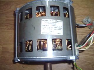

Hi guys I am still to find a decent motor,this is one I found in a washing machine,unfortunately I couldn't make a shaft within the tolerance required to spin free,
So another one bites the dust
I now have this motor,but don't know if it will be okay.
My electrical knowledge,is not good,
The motor I want to use,is
240v 60/60 hz cl.f
5,3 A. 0,28 hp. 2800 1/min
3 A 0,12hp 420 1/min
That is beyond my comprehension,
I have tried joining all the wires together,but it still spins free,
when attaching a small 12v battery,there is resistance in the shaft.
I will try and post a photo of the new motor,
as usual any help is much appreciated,thanks guys ,frank
And what do I do with all the wires? 7, I will need a bridge rectifier I think, to light a bulb? I am slowly learning,but still feel stupid asking questions,about simple things,thanks.Edited by frank133 2008-10-07

Frank,

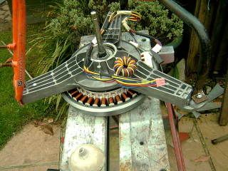

Your first motor looks like a F&P smartdrive motor or clone; I'd try making that one work, much better chances and less effort required than with your 2nd motor.
The 2nd motor is an induction motor with apparently two sets of windings, one as 2 pole (2800 RPM) and one as (I think) 12 pole at 420 RPM. Probably it came out of a washing machine that could do both washing and spin drying ? Most likely your motor is single-phase too. Next time you post a question about a motor, try including a good picture of the nameplate too, as it contains a wealth of information.
Anyway, the 2nd motor requires full conversion using neo magnets, it's unusable as is. And even as a motor conversion project it's less than ideal. It's normal that it brakes when you inject DC current into the windings of an induction motor, but that doesn't make it a generator.
Another option *might* be to use self-excitation with capacitors, using the 12 pole winding, but not a route that I would go for windpower either.
Read these links too:
http://otherpower.com/otherpower_wind_alternators.html
http://otherpower.com/otherpower_experiments_motor_convert.h tml
As said before, I'd try to make that F&P work as you already have it and as it's a much better generator than your 2nd motor ever could hope to be.Edited by Dinges 2008-10-07

The first photo is an LG, or clone, and not F&P.
The alu casting could be useful for mounting for a VAWT.

I cant use the first motor [I wrecked it]
