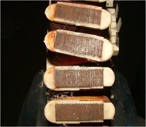

After recently speaking with Gordon, who has twisted the poles on his F&P with excellent results, I wanted to give it a go. Jarbar describes how he made a pole twisting tool using a mill on this page
here, but I dont have access to a mill or router suitable for steel, so I tried a different approach.

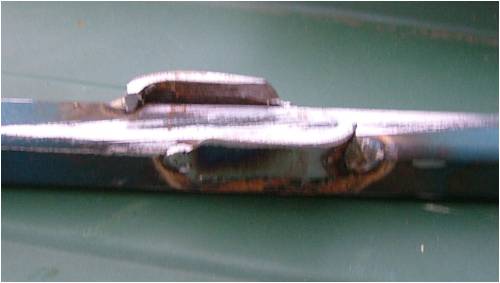

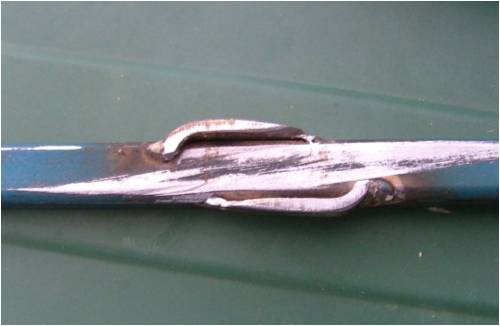

13mm RHS ( 1/2 inch box ) is almost the same width as the stator poles. I grabbed a length about 300mm long, and fabricated the two grippers from some 3mm flat mild steel. Each gripper has a bend at each end and are welded to the sides of the RHS, about half way along. Then I used a file to chamfer the edge as shown so when you twist one pole it clears the other two each side.
When I first tried it, it was a tight fit, but a gentle tap with a steel chisel on the inside edge gave the clearance to fit neatly over the F&P poles.
This is the result on a dead stator. Bottom two poles are original.
I was surprised how easily the poles bend, really no effort at all once you have the tool.

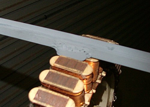

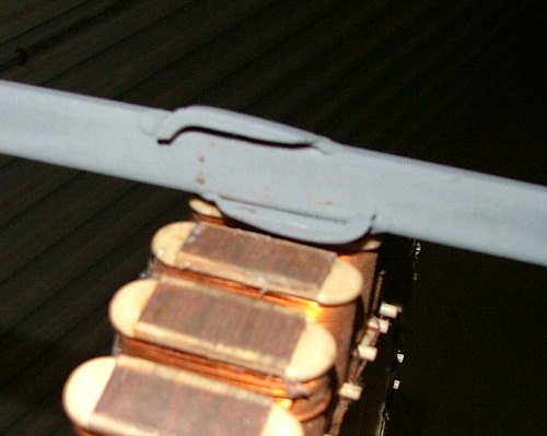

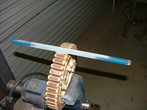

Hi Gill
The RHS sits against the face of the pole ( where the laminations poke through ), the grippers press against opposite corners of the face. When rotated, the grippers press against the plastic corners of the pole. The grippers are only about 3 mm deep, so there is no chance they will press against the coils. Once in place, I pull on one side and push on the other to twist the pole face around, easy as.
These pics might help, I've painted it since the last photos.

This is a little more elegant than the bar of an F-clamp that I used, just pushed down between the poles. How much dressing of the pole faces was needed to get clearance on the rotor?
The amount of angle you have will reduce the cogging a heap.
Gordon.
PS edit:
The bar I used was smooth sided. None of the enamel was damaged on the windings during the bending process. I did not rush it, which helps as well.

Hi Gordon.
Haven't dressed the pole ends yet, this was just a test run. Will do a whole stator this weekend.
