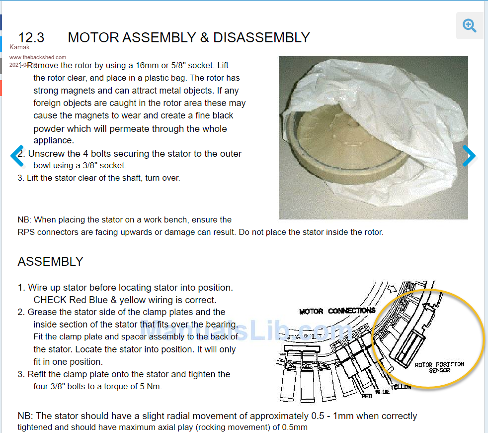

Kamak
Joined: 13/04/2021
Posts: 150
Posted: 02:25am 16 Apr 2021
Now I'm all very curious as to what models, that are/were being used for wind turbines, and the service manuals for these washers. I thought these were exactly like the Asian DD washers. Same rotor/stator design and these have hall sensors that use the back emf to sense position and speed. This is really weird.
"the Smart Drive DC motor."
https://www.manualslib.com/manual/1160699/Fisher-And-Paykel-Smartdrive.html?page=11#manual
Edited 2021-04-16 12:32 by Kamak
Kamak
Joined: 13/04/2021
Posts: 150
Posted: 02:39am 16 Apr 2021
OK, cool with this manual I also just discovered that yes the new 36 pole units are wound with aluminum wire.
Kamak
Joined: 13/04/2021
Posts: 150
Posted: 03:47am 16 Apr 2021
https://www.manualslib.com/manual/556089/Fisher-And-Paykel-Iw509.html?page=72#manual
So yeah, they are pulsed DC motors with hall sensor feedback servo control and use ESC drives, and they're brushless. They also produce an inherently "induced AC 3 phase sine wave voltage/current that can be utilized for power generation. This is classified as "Back EMF" produced by the permanent magnets induced into the stator.

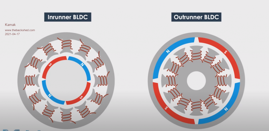

Kamak
Joined: 13/04/2021
Posts: 150
Posted: 02:24pm 16 Apr 2021
This is how these motors work.
https://www.youtube.com/watch?v=uOQk8SJso6Q&t=1s
