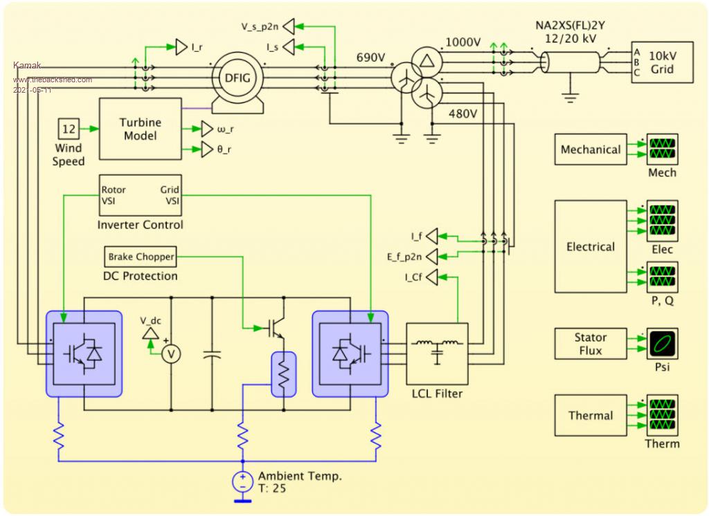

Is there no way to utilize more of the voltage range output for charging batteries? Some kind of voltage regulation that allowed a larger input voltage range?

  Quote  Is there no way to utilize more of the voltage range output for charging batteries? Some kind of voltage regulation that allowed a larger input voltage range?
Just what the Dr ordered?

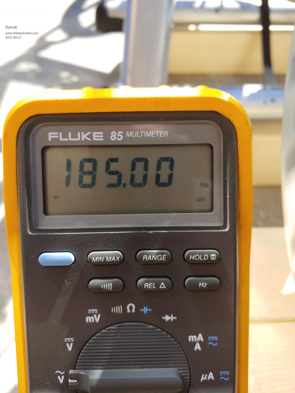

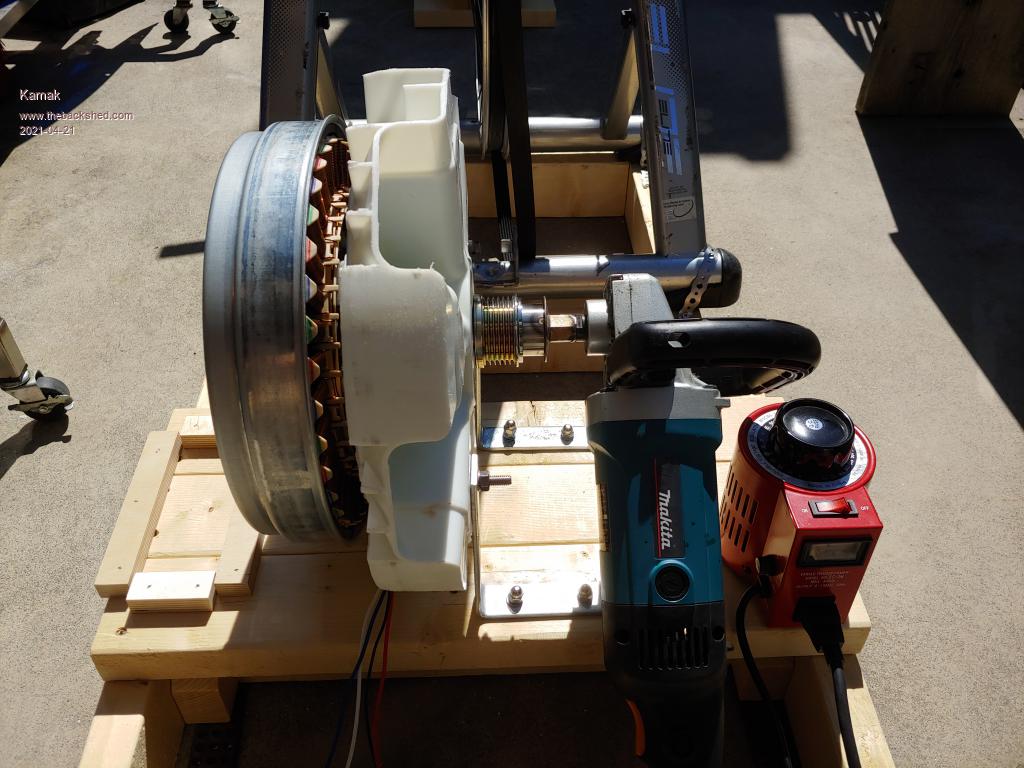

OK, I now have a method of steady rpm/power. I have only to get a reliable tack set up to read the rpms. I bought a crappy cheap digital noncontact tack, but it is so bad in daylight, it doesn't even work. the environment needs to be shaded and all reflective surface needs to be blacked out, except for the small stuck on a piece of reflective tape.
But as long as the frequency is below 200hz, I can calc it as:
200hz/24 full waves per rev. x 60 = 500rpm?

Posted: 11:26pm 20 Apr 2021
A new method of steady-state measurable RPM.
Edited 2021-04-21 09:28 by Kamak
Kamak
Joined: 13/04/2021
Posts: 150
Posted: 11:30pm 20 Apr 2021
185hz = 462.5 rpm
185/24 pole pairs x 60sec. = 462.5rpm

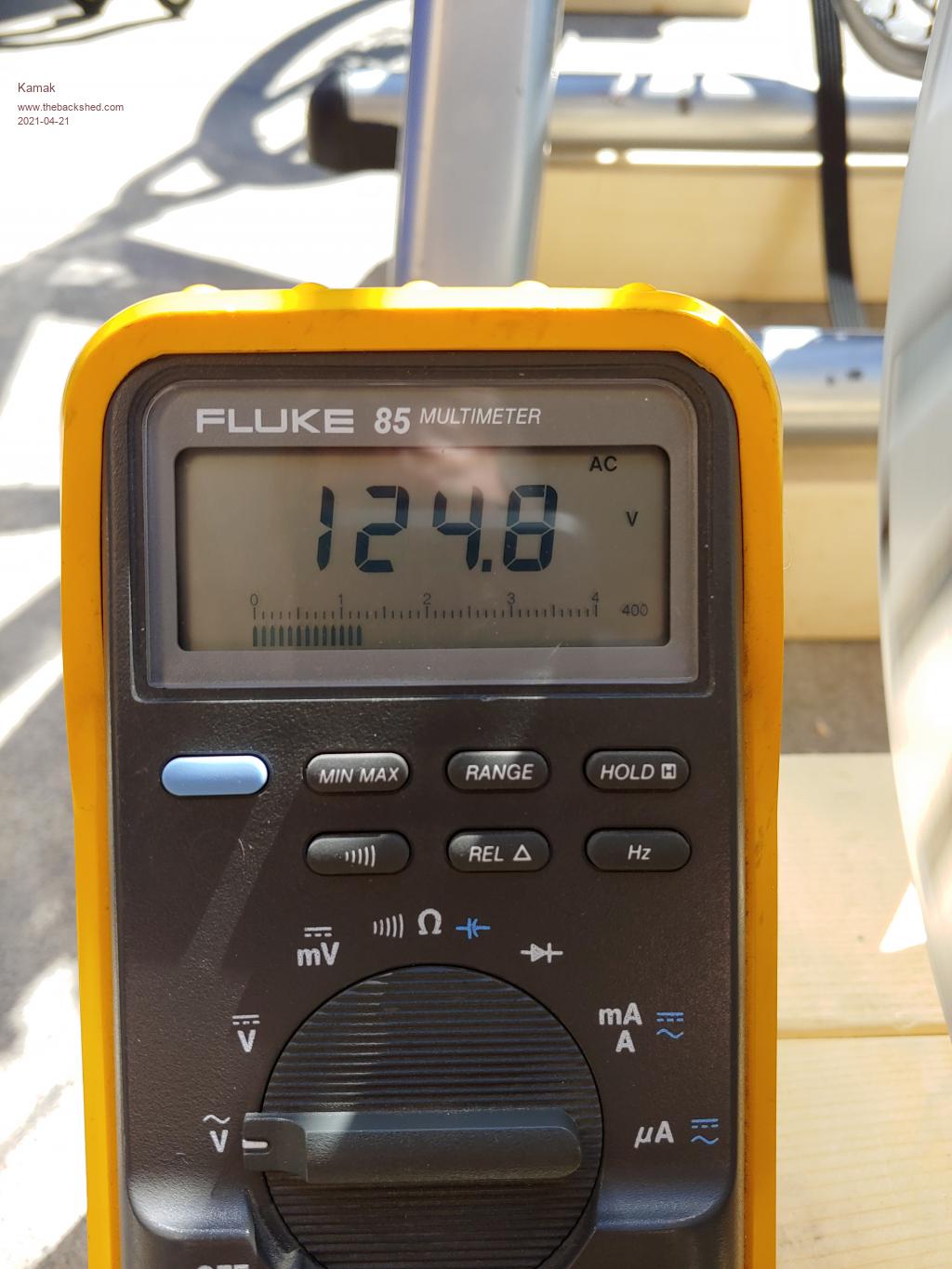

Posted: 11:32pm 20 Apr 2021
The stock voltage Vp output of one phase at 462.5rpm.

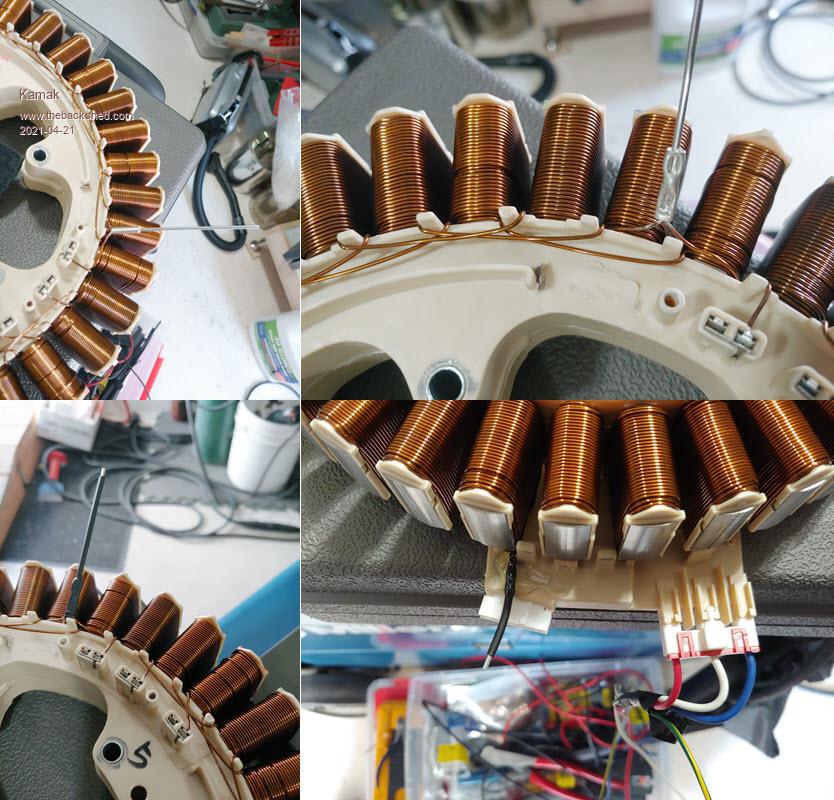

Posted: 12:03am 21 Apr 2021
Crimped on a common point connection.

Posted: 12:28am 21 Apr 2021
Ah dang, I put these pics in the wrong thread. See now this is why we need to be able to delete sh*t. lol Oh well

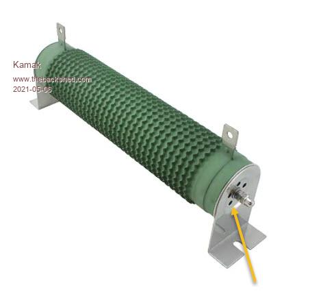

Anyone considered water cooling the coils during excessive wind periods to protect the coils from overheating? An electric solenoid water valve could open to allow water to spray the coils to cool them perhaps triggered by voltage generated? Internals would need to become water friendly. Taken to the nth degree hot water drained off might be stored and used?!

Yeah, those standard off-the-shelf dump-load resistors actually have a hollow core, which could facilitate water circulation. But that's a complicated setup on a tower 30+ feet in the air. I wouldn't use a dump load resistor to control rpm speed. I want to use an eddy current aluminum disc with a linear actuator/permanent magnet design. the magnetic flux drag phenomenon that occurs within aluminum, I believe, creates less heat generation, and to my knowledge seems to create a lot of torque. The question I still have is, how much torque can be created with disc masses, diameters, and magnets of reasonable sizes?

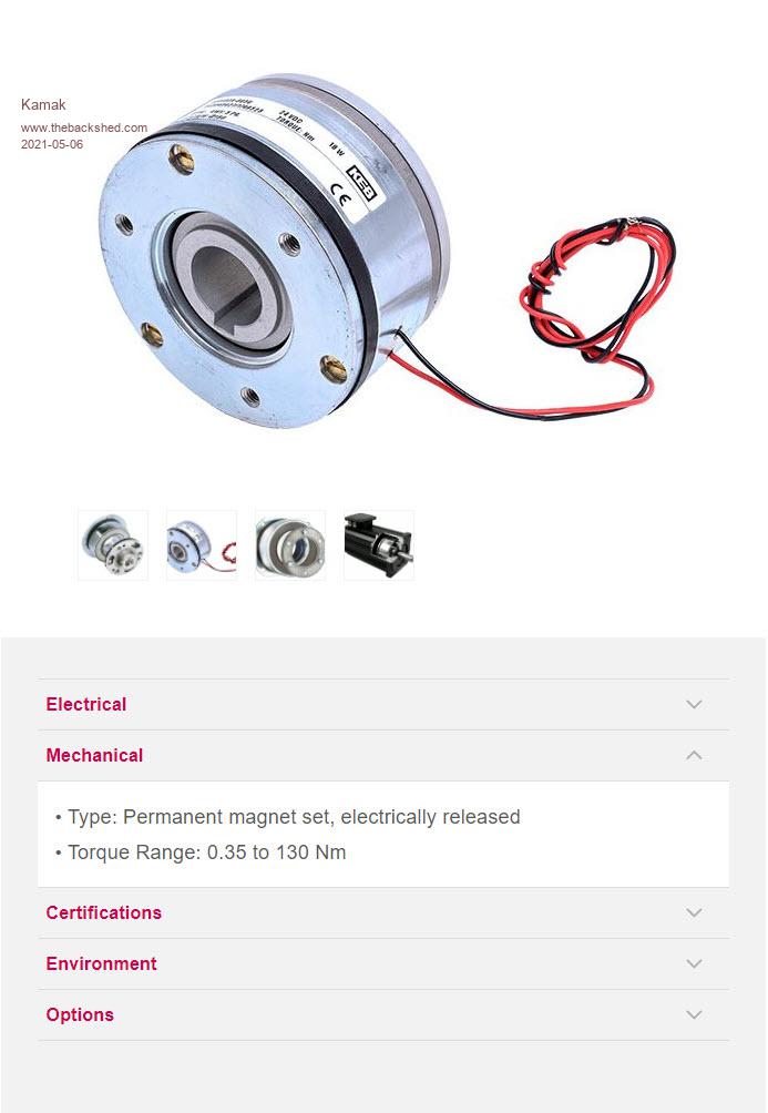

Eddy Current Absorber Brake/Clutch
