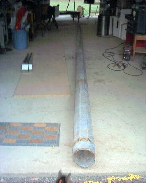

The guyed tower consists of an 8m octagonal pole as used for street lights with a 6.5m length of 3" water pipe ontop of that and then around 3m of 2.5" water pipe at the top giving a total of 17.5m.
This is the base of the tower after rewelding it back together as it was found in two halves.

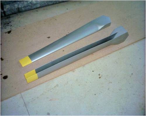

These blades are carved from laminations of 18mm plywood as per Hugh's instructions although I measured them today at only 1150mm long so the dia is 2.3m. They were then given kevlar leading edgesand carbon on the MAC and coated with woven cloth and epoxy resin. The finish is 2 pack paint.

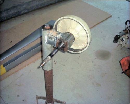

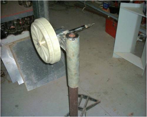

This is were I am up to with the head of the machine. It's based on a 60 series F&P which is wired for 2 pole star or delta. I wish I hadn't rewired it now as I think I am going to have trouble getting the voltage I need.
I still have to sort out the furling system. I had an idea to make a spline for the prop drive. I'll drill a series of 20 holes, 2.5mm dia on a 19.5mm PCD into a piece of 50mm bar. Then machine the centre out to 19.5mm which should leave me with a spline which should provide enough drive for the F&P system. Then weld the 50mm bar to the prop back plate and away I go. The dimensions might need tweaking but I'll double check that before I start machining.

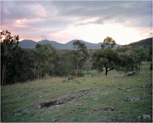

The tower will stand somewhere here. The tall tree's will be lopped. My problem is that the tower will be approx 82m from the batteries plus the height of the tower so say 100m. That seems a long way to run a potentially high curremt. My questions is, am I better off running the ac down tho the batteries and rectifying it there or should the rectifiers be up the top of the tower? I want to be able to switch from star to delta from the ground so I am guessing a three phase contactor will do the trick on top of the pole but I am unsure where would be best for the rectifiers.

The PL60 is no MPPT for the solar system. You are losing energy from the solar. I would upgrade the solar to a MPPT and use the PL60 to control the windmill diversion load, with a separate rectifier, so the battery is not cycled.
You have a 48V system, so current will not be excessive. 10mm conductors are probably OK.
