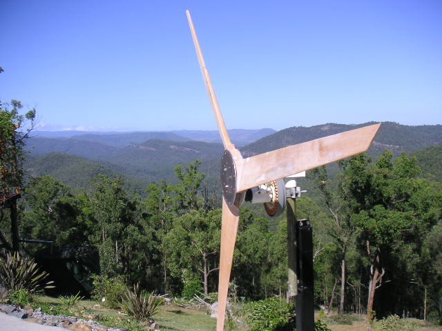

a couple pics of the progress I'm making with my new blades

Here's the twist , the top pic was the "art" blades, not supposed to post that .

Thats a big windmill, good to see you finally finished those blades. Very interrested to see how it goes, big blades and a 1:2 drive on a F&P, might just work.

Been watching your handywork for a long time now, and as always the thing looks great. Why did you opt for that tip shape? I saw something recently that said that shape (with more rounding) would lower noise and improve efficiency. However, by the shape of the blades your'e obviously going for a TSR of maybe 6 or something? where noise is'nt going to be an issue. Just interested in your thinking there.

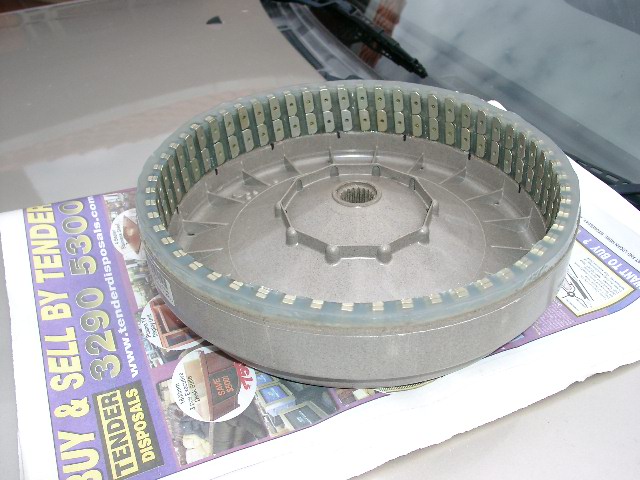

Also what shape are the neo's you used, and where did you buy them? Was it difficult to remove/fit them, and was it a worthwhile exercise?

Hello Mink. the tip shape I got from a posting I read about a long time ago -must dig up the details,but basically it went opposite to Hugh Piggots design-straight leading edge and the taper on the trailing edge. I have a full50mm drop in the chord width at the hub ,tapering to nothing at the tip ,blade is around 1700 mm length.
Have a look at the postings on this site for "Matt Lyons" ,he bought the neo's up to my place at Mt.Tamborine and we retrofitted then one evening-a bit tricky but he showed me how to do it . I'd say they definately are an improvement on the ceramics,but the cogging is still there.I've seen 800 watts out of the .6mm stator,and that was screaming,flat out. On a heavier wire stator ,I really think 1Kw is quite possible,we'll see.
