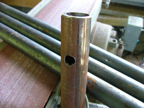

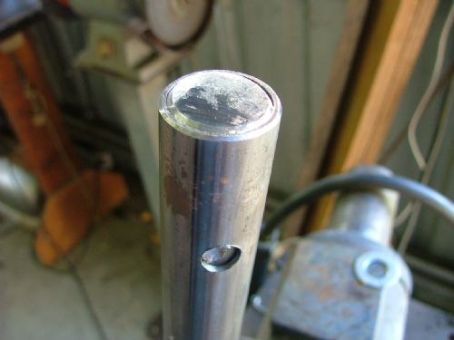

I bought 3 lengths of 1 inch (25.4mm) steel exhaust pipe at 1300mm long, and 3 lengths of 22mm steel rod at 400mm long. The 22mm rod is a neat fit into the exhaust pipe ( id of 22.2mm ), and will strenghten the root end of the blade.
First I drilled 3 8mm holes into the exhasut pipe at 50mm, 200mm and 350mm from the end. These are so I can plug weld the tube and rod together.

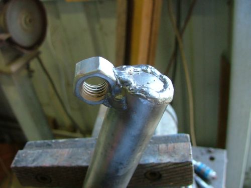

I then tapped the 22mm rods into place.
and welded around the end and 3 plug holes. I also welded a nut as shown, you will see that this is used for later.
The plug welds were ground back and the whole thing painted with zinc coat.

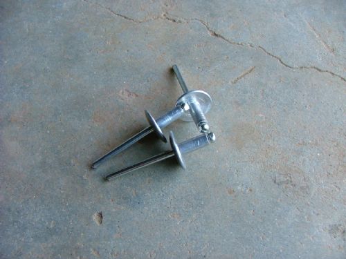

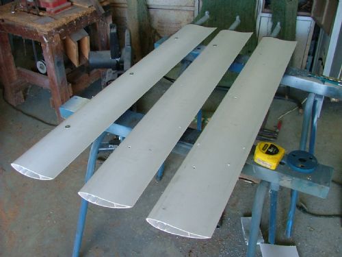

Next day, I cut 3 lengths of the PVC blade, each one 1150mm long. These were slid over the steel tubes and pop rivited in place with 5 rivits each, 3 on front and 2 at back.
I used a wide head rivit, though I could have used normal rivits, just more of them.
The end caps/winglets were glued in place with liquid nails. I also screwed in a couple of small self tapping screws into the winglets incase the glue didn't hold. I figure if the winglet falls off, the open end of the blade would make a hell of a whistling noise as the turbine spun around, so I wanted to make sure this wouldnt happen.

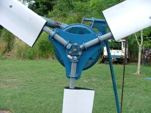

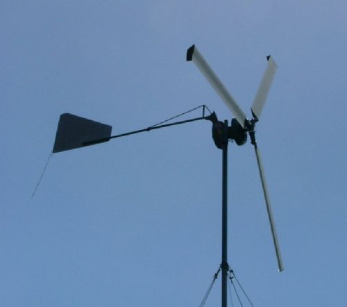

Next day, fitted the new turbine to the 2 stator F&P windmill.
I've used this hub before when testing the fibreglass blades.

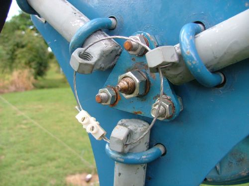

This is what the nuts were for. They stop the blades sliding out if the U-bolts work loose, and there is a security cable there, just in case.

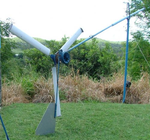

And finally up in the air.
Initially I set the blades at 5deg, but after looking at Royal Fabrication's site where they tested similar blades, I changed this to 10deg to keep the RPM down.
The turbine starts up easily, and so far they have been silent. Will post more in a couple of days.

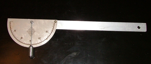

I made my own angle dial from a protractor, length of flat bar and a weight.
With the turbine mounted on the windmill or a stand, I first check the angle of the hub itself, just in case its not straight up and down. If its out, I'll add its reading to the readings at the blades. Then I rotate the turbine to get each blade level in turn, and use the dial to take a reading from the underside of the blades. If you put a straight edge under the blade, the reading is 3.2 degrees from the blades 0 angle of attack. So if I want a 10 degree angle of attack, I back off the U bolts and turn the blade to 13.2 degrees.
